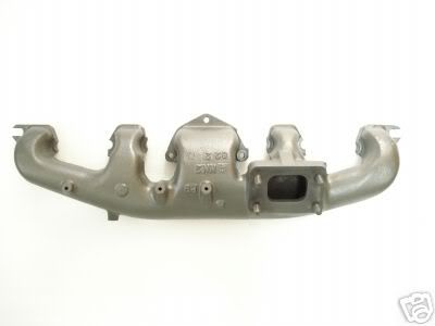

Guest mikewags Posted August 12, 2008 Share Posted August 12, 2008 Hi Guys, I have a 75' 280z; all stock. I am planning to install a 280zx turbo manifold, like the one listed below. I am new to the idea of setting up a turbo. What size/type of turbo would be able to fit directly onto the ZX Manifold (size of that opening for the turbo...flange?) What other kinds of parts would I need to complete this job? If I am running relatively low boost (7 - 8) would my engine be alright with the turbo charger added; being completely stock? I know people tend to change out the head/camshaft and pistons; but I would like to keep it all stock. I have tried searching on this subject, but have just come across a lot of confusing posts; leaving me with little useful information. Any advice or how-to links on adding a turbo to an L28E (stock 1975 280z) would be greatly appreciated because I am planning on making purchases relatively soon! Quote Link to comment Share on other sites More sharing options...
BurnoutZ Posted August 12, 2008 Share Posted August 12, 2008 A t3 turbo bolts directly up to the stock zxt manifold. I would recommend searching "parts for sale" for a "stock 280zx turbocharger". Those are t3 units... Quote Link to comment Share on other sites More sharing options...
