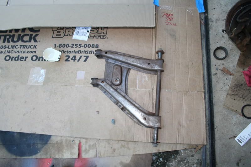

Oddmanout84 Posted September 24, 2008 Author Share Posted September 24, 2008 Daeron said: whats the mad scientist rust removal, baking soda and distilled water plus 12VDC? Proportions of each? youre right, that IS a duh.... Well, from what I've seen on video, its 1 teaspoon of baking soda for every pint of water. But really, it doesn't matter terribly if you put in more baking soda. Its just your money. The baking soda from my understanding is just a medium to make the water more conductive. As for power, I have a car battery recharger hooked up supplying a constant current of 2 amps. It was enough to kill a fly that landed in the water but to me it only tickled. Just don't mix up the polarity (pos goes to sacrificial metal, neg goes to what you want clean) and don't let the metals touch directly. You can also reuse the baking soda solution for at long as you want... it just gets dirtier, but it still does the job. I'm going to do my fuel tank soon, before I add the POR coating to the inside. Quote Link to comment Share on other sites More sharing options...

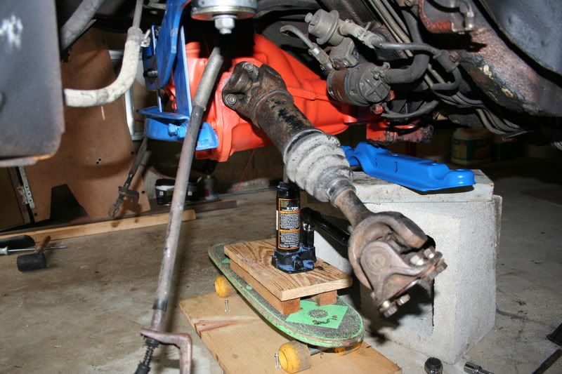

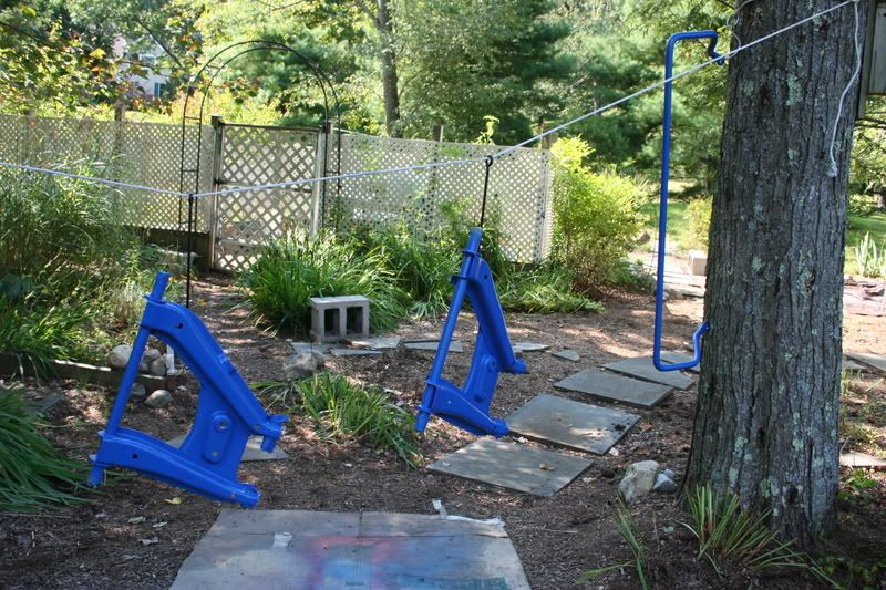

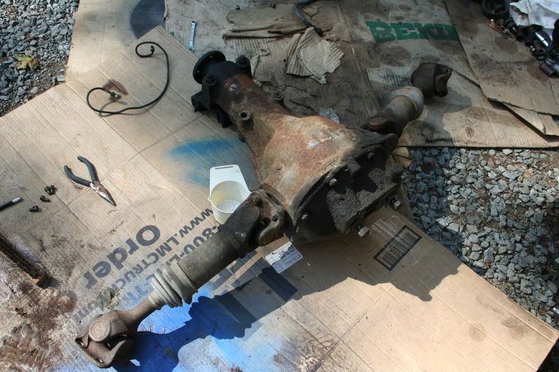

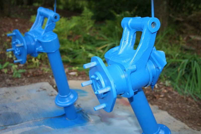

Oddmanout84 Posted September 25, 2008 Author Share Posted September 25, 2008 Bringing new life to old components I was silly and forgot to cover the threads The blue appears lighter in pictures than it really is I found out differentials are heavy... And everything was covered in oily filth... I wonder if I'm going to have to drain the fluid and service it... Hidden serial... Mustache fire Quote Link to comment Share on other sites More sharing options...

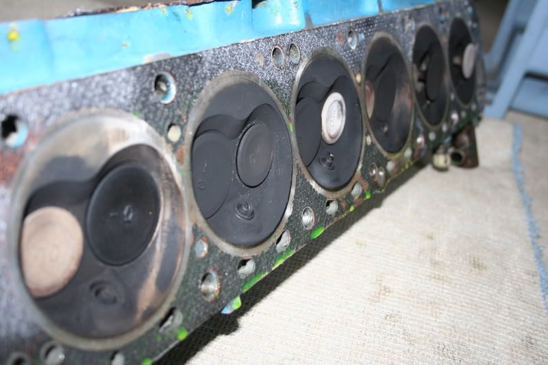

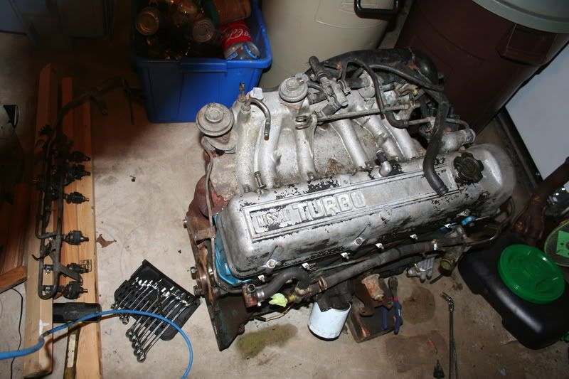

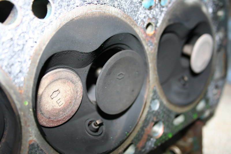

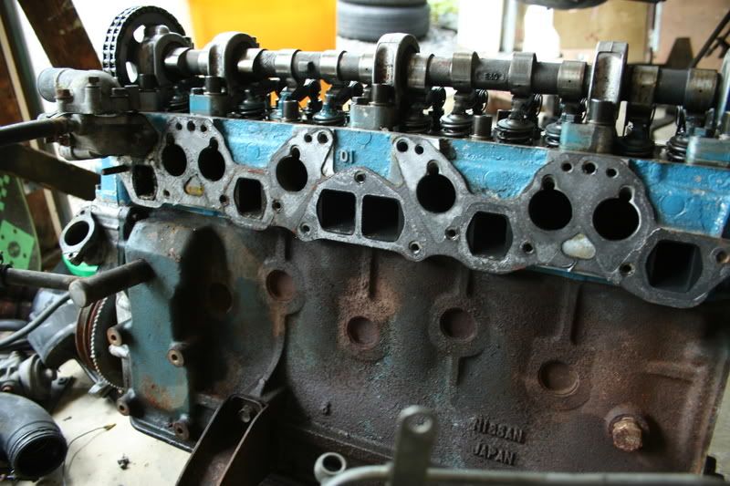

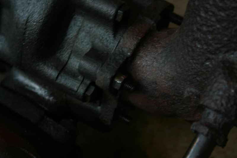

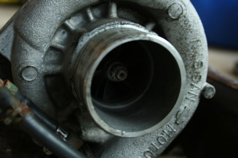

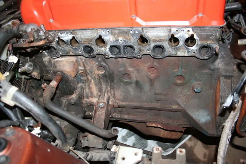

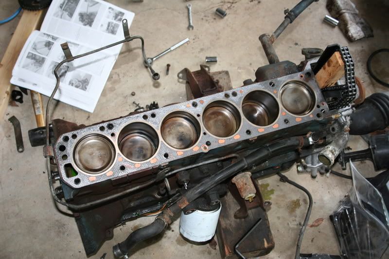

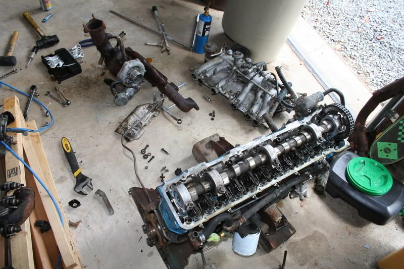

Oddmanout84 Posted September 30, 2008 Author Share Posted September 30, 2008 Well, last night I finally got the motor. Time to go to work. And I don't say this lightly. There is much work to be done on this little gem. Some goober tried painting the head baby blue at some point. Not only did he do a crummy job (flaking paint, and non-high temp), but he also failed to mask off the parts that he didn't want to paint. You really can't see much from the pictures, but there's overspray on some of the valve springs, lifters, and even the camshaft! Trying to get the downpipe off the turbo is an endeavor all its own. One of the nuts is positioned stupidly so its impossible to fit the box end of a wrench, and of course its the one thats stuck. The good news? The turbine seems to spin freely, as does the rest of the engine. The timing chain looks damn new, but I don't know if that's an indication that I'll find anything else new inside the block or head. I'd hope so, but I'm not holding my breath. Mainly, I'm just hoping nothing is seriously wrong in there. Besides that, I have almost no clue how i'm going to get it running! Hopefully I can track down the needed sensors (the crank angle sensor is gone, for one) and megasquirt it (another thing i'm only beginning to understand). Quote Link to comment Share on other sites More sharing options...

Oddmanout84 Posted October 21, 2008 Author Share Posted October 21, 2008 More progress, just because I haven't updated in a while doesn't mean the ball isn't rolling. The pumpkin is in! Its a little dirty, but I'll clean it up once I get the rest of it installed. Still waiting on a set of spindle pins. BTW, do you like my home-made trolly jack? For some reason I decided to spray the hood. I guess want to protect the car from rust until I REALLY paint it, but it wasn't nessissary. More than anything its a test to see how I like the two tone scheme... Thats a preview of what the finished product will look like in the future. The DUBS however, will not be a part of it. The manifolds are off. Interesting fact; I removed the exhaust manifold from the car entirely before touching the intake. I just had to try it since everyone said you had to remove the intake first. My secret; I'm not telling. Hopefully I didn't do something that I'll regret later. This is the mockup of the new exhaust headers. Yes, I know... My car's goal is one of the forced induction kind. You'll be happy to hear that even if my L28ET is sitting on the garage floor at the moment, it will eventually go in the car. Right now however I NEED to get this thing on the road, so the headers were a temporary solution. The turbo motor will be getting rebuilt over the winter, because I want to do it right. With luck, once I install the exhaust and the pickup coil in the distributor, the car will once again start. I know I was unsure of it at the beginning of my build, but now I'm almost 99% positive this is my problem. The engine IS getting fuel, I don't even need the noid light to tell me that now. What it isn't getting is spark. After testing the system with a new coil, testing with a spark checker thingy and running a multimeter on the pickup coil I know I'm not getting any spark. And since I can't find a reman distributor ANYWHERE, I'll have to go with replacing a few of the internals on mine. Bonus: Lets see if someone can recognise this car from the recent CTZCC outing. Quote Link to comment Share on other sites More sharing options...

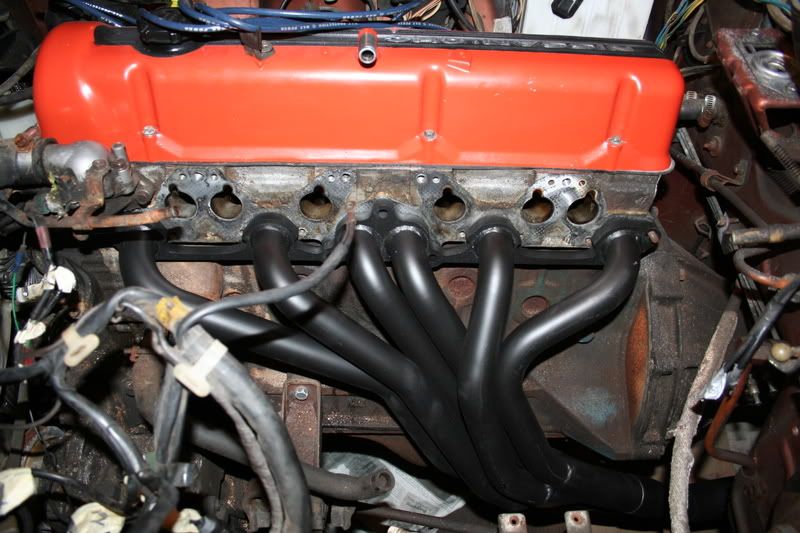

Oddmanout84 Posted October 22, 2008 Author Share Posted October 22, 2008 Thanks for the encouragement, its needed! Its been over four years since this thing last saw the road. After finally coming home and seeing her again its really discouraging to have to keep waiting till I can take her for a spin. I'm just about to scrape the last bit of protective paint off the headers so I can apply some VHT. I'm also going to need new boots for my ball joints (steering connectors). I don't know if the groove that I see in the ball is excessive wear or a design function for channelling grease(hoping for the latter). Regardless the condition of the boot shows me that this item in question has had close to none in terms of protection from the outside elements. One more headache. I just hope to god that with the headers on and the dizzy components installed that the car starts, or at least sparks. If not I may lose my mind. Quote Link to comment Share on other sites More sharing options...

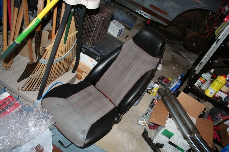

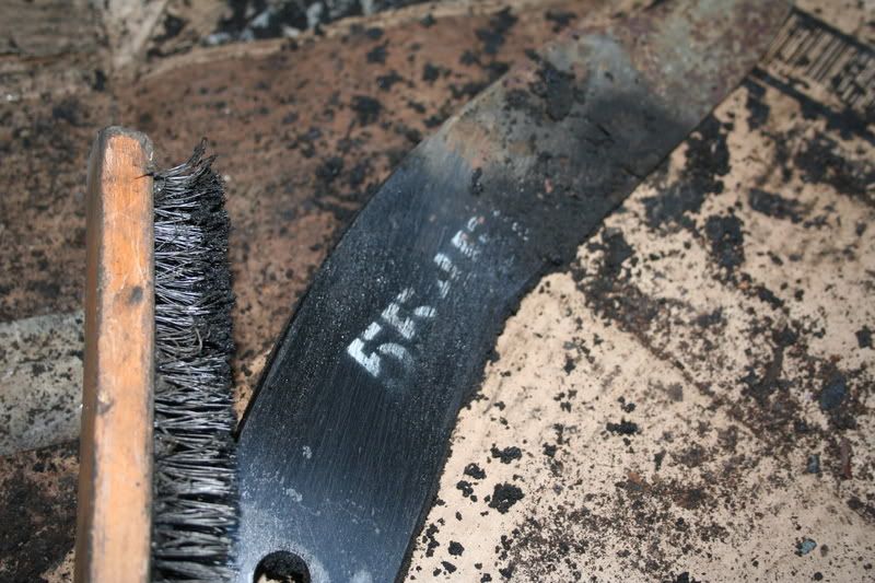

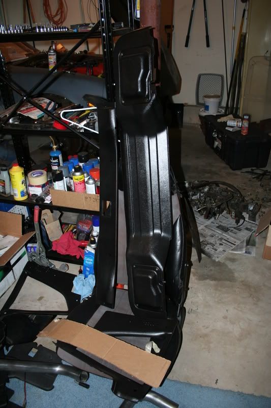

Oddmanout84 Posted October 23, 2008 Author Share Posted October 23, 2008 I think it looks better.... Besides, its VHT ceramic. The black stuff was applied by motorsport to protect it in shipping so it scraped off easily (but it still wasn't any fun to sand it off) I painted the vinyl a while ago too. The seat trim came out well, but the fuzzy fabric middle just soaked the paint to the bottom, so it still looks brown. The goal was to have a two-tone black and grey scheme. Paint used was duplicolor vinyl/fabric spray paint. The krylon colorbond plastic paint also worked great on a few pieces of the interior trim. Last night I bought a grease gun and warily decided to test out my zert fittings on the fwd suspension. To my suprise, they weren't clogged and purged well. What wasn't suprising was the nastiness that came out. Hopefully I'm using the right stuff, just general purpose grease. Autozone was out of the moly-based stuff I prefer. I'm going to try to use these steering arms for a little bit while I wait to get replacements. Quote Link to comment Share on other sites More sharing options...
Oddmanout84 Posted October 24, 2008 Author Share Posted October 24, 2008 AAAAAAAAAAAUUUUGH!!! Damn it! They're two different tones!!! Flying twice pipes Quote Link to comment Share on other sites More sharing options...
Pete Sprenger Posted October 24, 2008 Share Posted October 24, 2008 Hey, that's no big deal. Just paint the valve cover to match the headers and it will look sweet! A great place to get quality used parts (like a distributor) is Roger at http://www.zbarn.com. 1-800-247-2793 He is great and ships right away. I bought tons of parts from him when I built my 3.1L stroker. Pete Sprenger 1972 240Z Stroker Quote Link to comment Share on other sites More sharing options...
