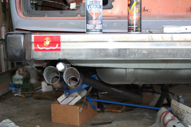

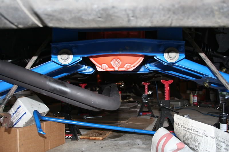

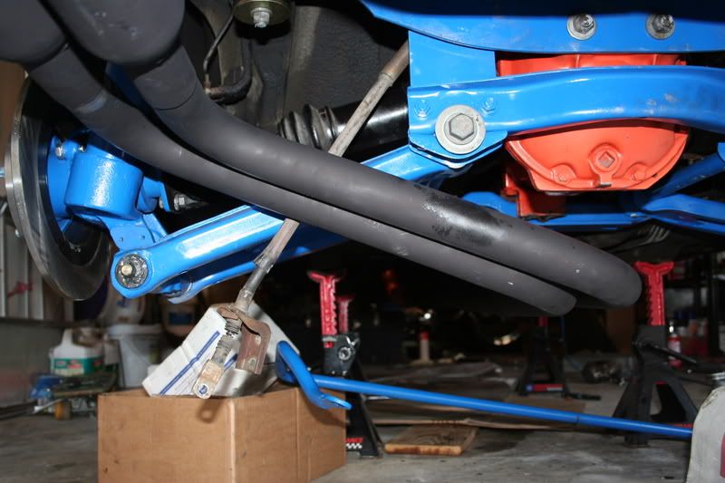

Oddmanout84 Posted November 9, 2008 Author Share Posted November 9, 2008 Installation is final. I'll have to wait and see if there's anymore tweaking to do. They fought against installation a little bit, but in the end I won. No modifications other than paint were needed. Looks like they went in straight, but I have yet to take a level to the tips to see if its exact. Only thing I don't like is that they go almost directly under th diff and once I remove that bumper they're not going to be flush anymore. I mean, they're going to stick waaaaay out! Quote Link to comment Share on other sites More sharing options...
