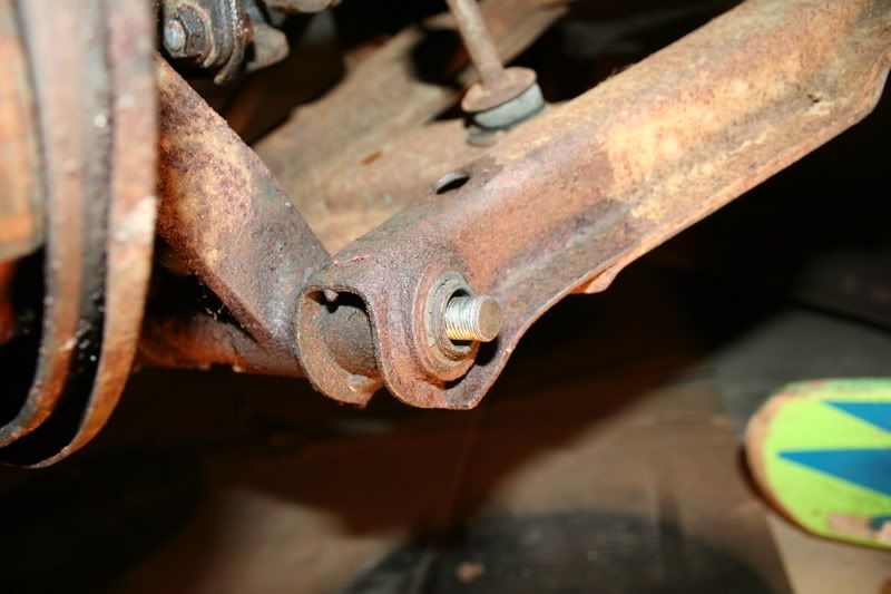

Oddmanout84 Posted August 29, 2008 Share Posted August 29, 2008 Ok, I know I'm probably beating a dead horse with this one, but sometimes the horse just isn't quite dead yet... If you're like myself and are working on a project car (or anything in general) and have decided on the do it yourself method, at least do it right. One of the best ways to reduce your margin of error is to use the right tools for the right job. I'll keep this thread short, but at least it should give a general idea. First, if you're going to do things yourself and have the pride of doing so, one of your greatest investments is a set of quality tools. I understand that a lot of us are on a budget, but there's no use going out and getting yourself a cheap set of tools that's going to break on you the first time you use it. Case in point: Grandma was very kind in giving me the toolset that this came in several years ago, so I'm not going to knock on her. But if you're the one spending the money, get something that at least has a good name. This 17mm socket was practically brand new when I first used it to remove the nuts on my transverse link. I hadn't even applied very much torque on the breaker bar before it shattered. Not only did this suck because I would have to buy a replacement socket, but I was lucky that the shrapnel that flew off didn't go in my direction. After stomping around and cursing I let anger get the better of me and applied a 17mm wrench to the same nut, then stomped it to break torque. The wrench was from a small higher quality duralast set and did not break or deform. I understand that not everyone (including myself) can afford to go out and buy a craftsman or snapon set, but the least you can do is buy something from a reputable hardware store (or if you're lucky, borrow some tools from someone you know who has a good set). I firmly believe that a good toolset is your greatest asset, and it will save you money and frustration in the long run. Next, for the sake of your project, use the right tools for the right job. This means using them for the jobs they were intended for. Use wrenches and sockets for bolts and nuts. Using a set of vice grips or channel locks is fine when you have no other option, but unless you want to strip and replace every piece of hardware you work on, use sparingly. Don't substitute this for the right sized wrench or socket just because you don't have one... If you're working on your brake system, this will be one of your best friends. It's usually called a flare nut wrench. When I started on my brake system the other week, I was working out of a Haynes manual. After having a hell of a time removing the fittings for the ridged lines I took a break and found a Factory Service Manual online (This will also be one of your greatest assets. Get one). In it is displayed a note that states clearly "DO NOT USE OPEN FACED WRENCHES ON BRAKE LINES." Had I seen this before, I wouldn't have almost stripped my fittings. Back to the transverse link. See the threads on the pivot bolt? As you'll find in some other threads the S30 spindle pins are one of the least fun things to remove. I tried to take this on without searching around to see why it wouldn't budge (yes, I removed the lockpin first). I started off mildly enough but once again I let frustration take hold of me and ended up hitting the ends with a hammer. Now I have a mushroom that I cannot eat. The FSM and Haynes manual both show this picture for the removal process: Yeah, right. Once again I searched the forums after the fact and found there's an interesting device that someone fabricated called a spindle pin puller. Its expensive, but from what I gather several users from this website or zcar.com have them and loan them out. I'll have one too, shortly. Two more bonus links for a couple of people removing coil springs off of their struts. The first one is impressive, but I'd have to say its an isolated case that shouldn't be reattempted: Hopefully those links work. I know a lot of this info may seem pretty redundant for most people here, but it can't hurt to repeat useful information. Especially for relatively new mechanics such as myself. The bottom line? Use common sense, and do things the right way. Quote Link to comment Share on other sites More sharing options...

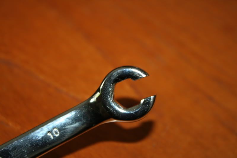

m4xwellmurd3r Posted August 30, 2008 Share Posted August 30, 2008 man, I'm glad I got a 170 (?) peice craftsman set for x-mas. also, flare wrench's are your friends. I even used it to take off my fan to make sure I didn't screw up the little nuts holding it on. Quote Link to comment Share on other sites More sharing options...
