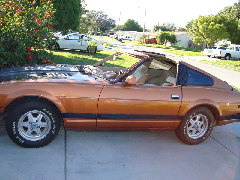

tpnorth Posted October 29, 2008 Author Share Posted October 29, 2008 yeah i think i am hearing the injector thats where it sounds like its comming from. Recent purchase on the car? What do you mean like did i just get the car if so yes i got it two weeks ago 400 bucks and i was told it didnt run but it seems okay now that i got alot of the little things will be heading to the body shop now to get the rust dealt with. Quote Link to comment Share on other sites More sharing options...

tpnorth Posted October 29, 2008 Author Share Posted October 29, 2008 Hmm maybe the kid was located in st pete fl i picked it up off a local forum in tampa. Oh its not the anniversary edition just a similar color but all and all its not to bad normal rust but for 400 bucks and the extra parts i got i couldnt pass it up. Quote Link to comment Share on other sites More sharing options...
ckolander Posted December 4, 2008 Share Posted December 4, 2008 You know, I don't see a whole lot of rust here, great buy by the way, I wish mine was as clean as this......However, I think there may be something wrong with your windshield. Is anyone else seeing this.. Quote Link to comment Share on other sites More sharing options...
