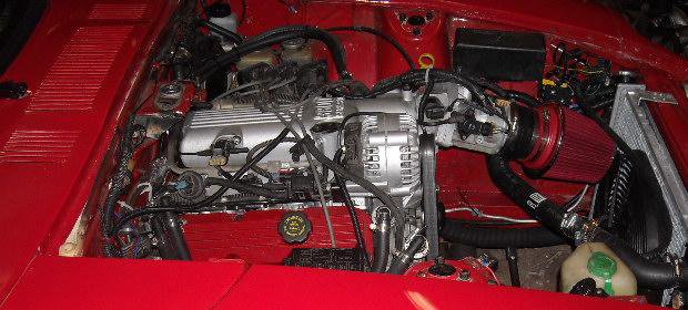

twalton Posted November 10, 2008 Share Posted November 10, 2008 Well, I finally got the car on the road and am quite pleased with the results at this point. My goal was to have a very mild mannered daily driver with a significant power upgrade over stock(74 260) with good fuel economy. The t5 works great with the stock differential ratio and is very quiet at cruise with the dynomax superturbo muffler/ 2.5" mandrel exhaust I fabricated. I used a 1st gen. RX7 fuel tank with a "modified" FI maxima fuel pump assembly.(in tank, very quiet) I used a tilton clutch master which required some minor hydraulic adapting to the stock camaro hydraulic TOB. I "modified" some 3.8 camaro pacesetter headers to clear the frame rails. I am guessing the car is around 150 pounds lighter on the front end than stock....definitely livened up the steering. With the mods from stock I am guessing around 225 horse. I know, pretty anemic compared to some swaps but it moves pretty good for a lightweight DD. BTW, I picked up the COMPLETE motor/trans/pcm/FI harness for about $300 at pickapart. I have prob. $1500 in the swap since I completely went thru the motor.Anyway, take a look at the pics and feel free to post questions... Quote Link to comment Share on other sites More sharing options...

Dirk Gently Posted November 11, 2008 Share Posted November 11, 2008 Very nice. How close is it to the firewall? More pictures please. I've had people tell me that those are harder more expensive to mod then a V8 (I doubt it). But, who cares, like you said, its lighter. Quote Link to comment Share on other sites More sharing options...

twalton Posted November 11, 2008 Author Share Posted November 11, 2008 Thanks for the comments... The engine sits real close to the firewall(w/in an inch) in order for the shifter to exit close to the stock position...I had to modify the shifter some due to the stock tilt of the camaro bellhousing. I havent hooked up the speedo yet but I feel the MPG will be much better than I was getting with the stock L6/SU combo. As far as performance enhancement,the aftermarket is much more limited than what is available for the Ford/Chevy V8s. A supercharger is offered by a couple of companies and forged rods/pistons, etc. are available for forced induction reliability.I may look into a few add'l mods in the future. Quote Link to comment Share on other sites More sharing options...

twalton Posted January 11, 2009 Author Share Posted January 11, 2009 KRAYZ, I welded up a custom crossmember which spanned the frame rails and also tied into the original mount pedestals. I modded the original datsun motor mount brackets(basically shortened them and adapted them to camaro block) and retained the stock Datsun rubber mounts. A custom trans bracket was also required. Anyway, I have been real happy with the conversion as it yields good power/fuel economy. Also plenty of room up front for possible forced induction mods. Good luck with that 3.8 ford swap. Should be a good driver. Quote Link to comment Share on other sites More sharing options...
