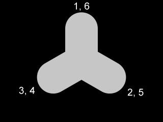

If one piston is @tdc then one piston is @BDC right? Measure the difference.
That would hold true for a V-8 or 4 cylinder, but not a 6 cylinder. most 6 cylinders, (all Datsun/Nissan L-6's) crank throws are 120 degrees apart. The pistons travel in unison in pairs. 1-6, 2-5 and 3-4. In the 4 event cycle, these paired pistons are in the opposite event from each other, i.e. if one is compression, the other is exhausting. If one is on the intake, the other is on the power stroke.
At any rate, with 2 pistons at TDC the other 4 pistons are at the same distance down the bore, not quite at BDC. 2 are on the way up, the other 2 on the way down.
This illustration shows typical inline 6 cylinder crank-pin lay out.
