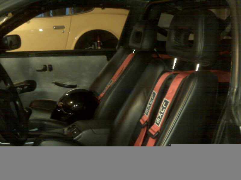

jerryb Posted November 24, 2008 Share Posted November 24, 2008 After 3 weekends of cutting, welding and fitting I finaly replaced the stock cloth 240SX seats with leather infinity seats. This is a track car used only for lapping days so hard core racing seats are not required. The passenger seat is fixed while the driver seat is on tracks...little high but I have about an inch of space between my helmet and the roof. Pretty comfy for a track car. .....what do ya think? One question....the drivers seat is bolted to the floor...how thick and what size should I place below the floor to prevent the bolts from tearing through in case of a mishap? Quote Link to comment Share on other sites More sharing options...
janaka Posted November 24, 2008 Share Posted November 24, 2008 Looks very good Jerry. Those look very comfortable One question though, whats the yellow thing with no wheels? Quote Link to comment Share on other sites More sharing options...
jerryb Posted November 24, 2008 Author Share Posted November 24, 2008 The car I pulled these seat from! Looks very good Jerry. Those look very comfortable One question though, whats the yellow thing with no wheels? Quote Link to comment Share on other sites More sharing options...
janaka Posted November 24, 2008 Share Posted November 24, 2008 Ah, right, I forgot on those turbo models that the wheels have to be removed before the seats will release. Quote Link to comment Share on other sites More sharing options...
slownrusty Posted November 24, 2008 Share Posted November 24, 2008 Which Infinity did those seats originally come out of Jerry? Yasin Quote Link to comment Share on other sites More sharing options...
jerryb Posted November 24, 2008 Author Share Posted November 24, 2008 I believe a G20.... .they fit in the Z but are a bit wide and high on the stock Z mounts. Look nice and comfortable. I switched to Solstice seats in the 240Z as these look close to the original Z seats. Quote Link to comment Share on other sites More sharing options...
silverarrow27 Posted November 27, 2008 Share Posted November 27, 2008 I have a pair of s14 base model seats sitting around. What did you have to fab/mod to make the 240sx seats fit into your car? Quote Link to comment Share on other sites More sharing options...
jerryb Posted November 27, 2008 Author Share Posted November 27, 2008 I never put SX seats into my Z ...just the G20. I made a couple of crossmembers and bolted the stock Z rails to them.(after removing the G20 rails). It was pretty straight forward. That way they mounted to the stock floor seat brackets. The SX seats should be similar. Quote Link to comment Share on other sites More sharing options...
