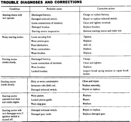

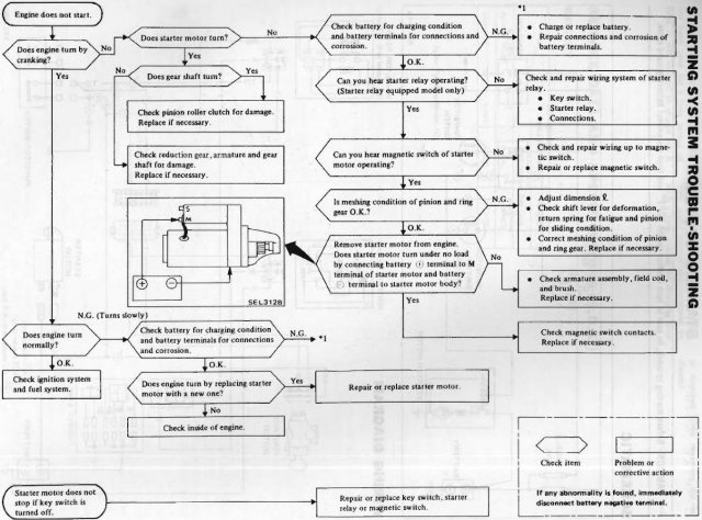

Hyuri Posted December 3, 2008 Share Posted December 3, 2008 i cleaned the battery terminals and used dielectric grease. sam problem after. its not the battery. Those aren't the only steps required to rule out the battery. Do you know what's the voltage across the terminals? What kind of cranking amperage is your battery providing? Is the battery fully charged? Is it still good? Have you checked your grounds? All of them? What's the resistance of your battery cables? Are any of the other electrical connections in the car corroded or dirty? Pull the battery and the starter and take them to Autozone, have them tested. Attached are two diagnostic pages for starter problems, from an '83 and a '76 FSM. Hopefully you'll find them useful. Quote Link to comment Share on other sites More sharing options...
