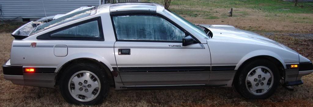

ArnZ Posted December 9, 2008 Share Posted December 9, 2008 ">">I am now officially in the Z31 club. I just bought a 84 Turbo with 160K that runs for $800. The car has four rust spots on the body (surface), and no rust anywhere else. It needs a radiator, master or slave cylinder for the clutch. AC doesn't work. All original never been wrecked, original radio, seats are good, dash is cracked, needs a headliner. I think I did good, it's a Z to drive until my Fairlady is finished. I will tow it home tomorrow and get some pictures posted. I only have what the owner took. Arnie Quote Link to comment Share on other sites More sharing options...

ArnZ Posted December 11, 2008 Author Share Posted December 11, 2008 "> I got the car home yesterday. I put some gas in it, fresh battery and it started right up. Has a little valve tick but I have not checked the oil. It's going to need a radiator, exhaust and tires. I could not drive it because the clutch pedal falls to the floor, so I will need to address that. Everything works, lights, windows, locks, turn signals, heater/fan, radio, antenna, power mirrors. Interior is filthy but is all original even floor mats. Quote Link to comment Share on other sites More sharing options...

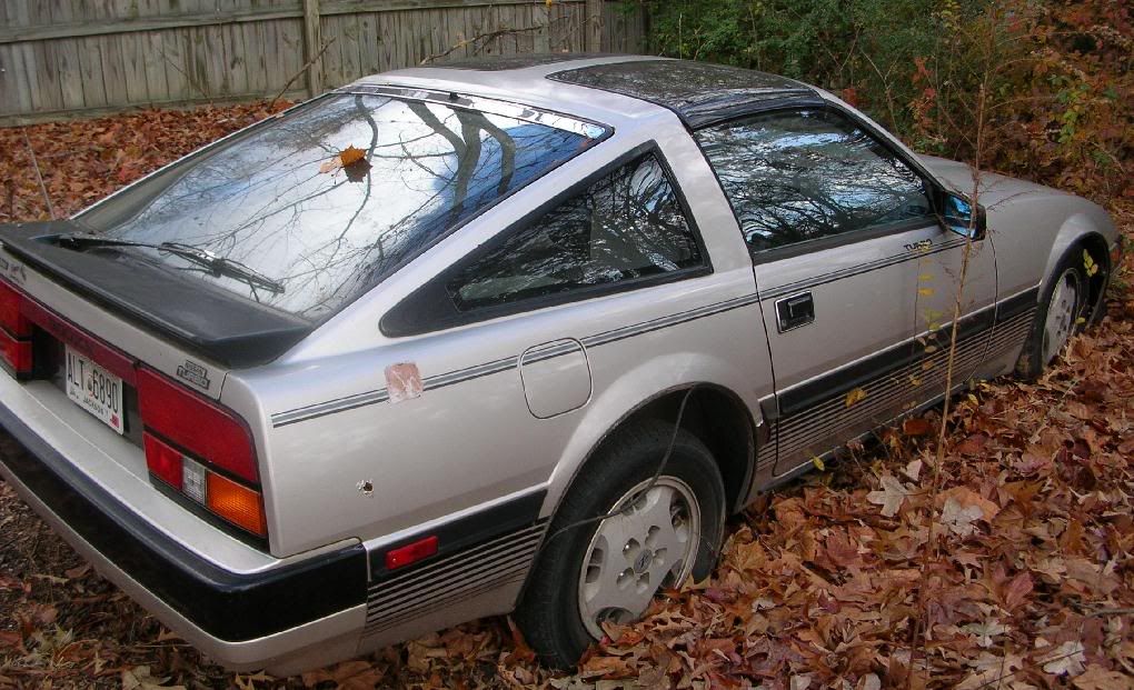

BunnySlippers Posted January 12, 2009 Share Posted January 12, 2009 Nice buy. Looks from the pictures that your definitely going to need to replace the rear quarter window seals. And be sure to check the spare wheel well and driver side rear for water damage. Pretty easy to do, done it on 3 of the 4 Z31's I've had. I'm getting more and more motivation to get my 88 running again, and turbo swap while I'm at it. Just need to get my 75 going first. Quote Link to comment Share on other sites More sharing options...
ArnZ Posted January 12, 2009 Author Share Posted January 12, 2009 I am going to address the rear end issue then get on the engine. I guess I need to pull the lifters and clean them, do the timing belt and water pump and heed NissanEgg's advice on the seals. "Looks like you got a great deal! If there are any parts you need, my brother and I are parting out an 84 ae, so if you need anything we probably can help you" I do need some interior pieces "Nice buy. Looks from the pictures that your definitely going to need to replace the rear quarter window seals. And be sure to check the spare wheel well and driver side rear for water damage. Pretty easy to do, done it on 3 of the 4 Z31's I've had" The wheel well is good, but I noticed that the rear right side has bolt in panel that needs to be replaced. Overall this car does not have major rust issues! When I get the suspension/rear end issues and the engine clatter gone. I will be finally be able to drive it for more than 100 yards. The PO stated he had a good bit of service done to the car and was to furnish a stack of receipts to me, but could not find them. He was a little vague about what was replaced and when, so It went through one ear and out the other. In that stack was new timing belt and water pump receipts. Is it easy to discern a recently replaced belt, or is it not worth risking? Arnie Quote Link to comment Share on other sites More sharing options...
