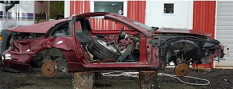

Administrators BRAAP Posted January 11, 2009 Author Administrators Share Posted January 11, 2009 Yuk I don’t get it guys? The mock up mule is HOT! All 4 four corners and roof have custom body work, well ventilated cabin, dash isn’t cracked… You mock it now, but one day… it’ll roll again… … on a trailer on its way to the scrap yard! Quote Link to comment Share on other sites More sharing options...

Administrators BRAAP Posted January 14, 2009 Author Administrators Share Posted January 14, 2009 Are the log jackstands a West coast phenomena or is it exclusively a Northwestern thing? In the larger cities such as NY, LA, Chicago or SF, concrete blocks are the preferred static nonadjustable jack stand. Here in the beautiful Pacific North West, Douglas Fir is not only the preferred static nonadjustable jack stand, but also doubles as a source of heat on a cold wintery day… Here is shot of my two oldest daughters and Charlie Brown (the worlds dumbest Rhodesian Ridgeback) hauling a load of Datsun/Nissan/Infiniti jack stands up to the house to be used as heat on a cold Sunday afternoon while watching NFL Football! Quote Link to comment Share on other sites More sharing options...

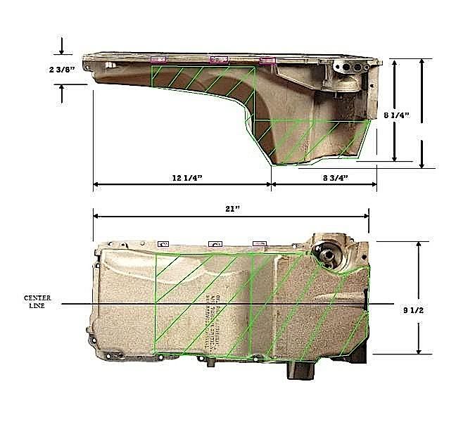

hoov100 Posted January 17, 2009 Share Posted January 17, 2009 you know any 98-02 camaro/firebird and 05-09 vettes use an oil pan that's only 5 inches deep right? *cough* (im sure you have already been their though) Quote Link to comment Share on other sites More sharing options...
Administrators BRAAP Posted January 17, 2009 Author Administrators Share Posted January 17, 2009 Sorry of the lack of update recently. Haven’t been able to do any more work on this as I have a couple of custom L-6 cylinder head projects that have been here in machine-shop jail long enough and need leave the shop THIS WEEK! At this point, I still plan to stab the VH45DE in the engine bay for pics, though with my increasing desire to play with the LSx, that would mean the VH45DE would go up o the block. I am pretty sure the VH45DE will bolt in the car using the Z-32 5 speed with much greater ease than getting the LSx and T-56 in the car, but the more I study the LSx the more attractive it becomes and the more fab work I’m willing to tackle, (firewall is to remain intact!) Quote Link to comment Share on other sites More sharing options...
Administrators BRAAP Posted January 17, 2009 Author Administrators Share Posted January 17, 2009 you know any 98-02 camaro/firebird and 05-09 vettes use an oil pan that's only 5 inches deep right? *cough* (im sure you have already been their though) Yeup, been to the *cough* page which is where I got the pics below and... *cough cough*, (I'm sure you have already been there though) I also recently received an F-body pan from a HybridZ member, and have had an ’01 Vette bat-wing pan for a few years, along with my truck pan. Still need to get the front sump GTO pan. Problem with the those 5” deep pans is that they are 4” inches too deep where the rack and pinion goes. This picture of the truck pan shows where I need to modify the pan to clear the rack, (middle section), and shorten so it does not drag the ground, i.e. bring ht bottom of the pan to the same leave as the bottom of the cross-member! As compared to the Vette and F-bod pans pictured below it, you can see by cutting either of those pas to clear the rack, essentially leaves very little oil capacity left. Removes the entire Batwing section of the Vette pan! My truck pan! F-bod pan, courtesy of LS1tech.com. C-5 Vette pan, courtesy of LS1tech.com I just found this regarding the trans and the CTS V trans with the GTO oil pan just may be the hot ticket! Quote Link to comment Share on other sites More sharing options...
