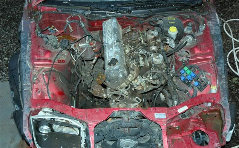

L-26 in the engine bay of the Z-32 mock up mule... :lmao:

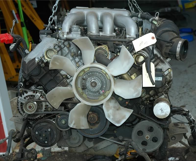

Alright, yanked the VH45DE out of the Q-ship tonight. Cut off the upper and lower front core support of the car, unbolted the engine and trans crossmembers and removed the entire assy including steering rack, etc from the car out through the front using my tractor. Ron Tyler was present and helped in the final stages of the removal. Set the engine/trans on the shop floor, got down off the tractor, stood there at the shop door with Ron and we both had the same reaction as we stared at the VH45DE sitting on the floor! “OMG!” shock.gif This thing is physically HUGE! It is wider than it is long and tall! :shock: The VH45DE has now been dubbed, "GIGANTOR"!
Tomorrow I’ll take some pics with the LM7 5.3 next to it, and hope to weigh it, finally putting to rest the VH45DE vs VG30DE weight debate, (claims elsewhere on the internet of the VH45DE being upwards of 100 lbs lighter than the VG30DE)! scratch.gif

Spent some time stripping the VH45DE down to just the engine, removed the alternator and its bracketry, A/C pump and its bracketry, P/S pump and its bracketry, the transmission and flex plate, starter. With Rons help, weighed it! Came in at exactly 500.6 lbs. Weighed an N/A VG30DE on the same scale in the same trim approx a year ago at 442.2 lbs, so the VH would add approx 50-60 lbs give or take. For a car that weighs in the 3500 lbs region, another 50-60 lbs wont be noticed with the additional torque. wink.gif
(Oh, and the VH45DE still weighed 30 lbs MORE than the similar equipped VG30DETT on the same scale, busting the myth of the VH being lighter than the VG30DETT...) hot.gif
GIGANTOR as removed from the Q-ship with everything still attached!
All accy removed during the weighing.
