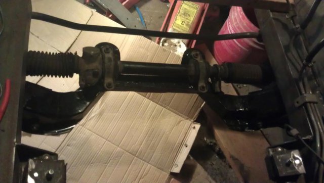

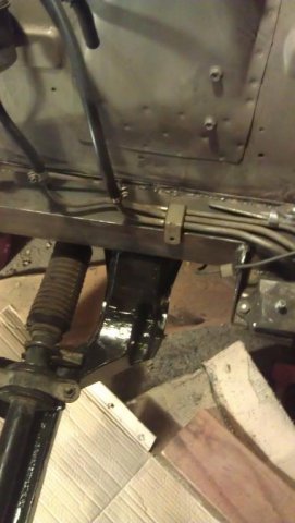

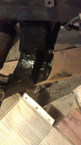

Pharaohabq Posted July 1, 2013 Author Share Posted July 1, 2013 (edited) Well it's been some time since I've got to post any progress, since having a kid and all has taken a lot of my spare time away, not to mention funding. As I mentioned before, I'm still in the tearing down for pain phase of my project, but it's nice to start putting some things back together. Here's some pictures of my Steering Crossmember I'd put back in so I can get the car back on it's wheels. Here's the Steering crossmember bolted back in place. Sorry the Black is hard to show detail, but you can see how much we cut out. It's reenforced under the Rack. In this detail you can better see the cutout for the HR oil filter. I should still be able to clear at least 1/2" around the filter. I cut it mainly because I didnt' want anything to rub. and zoomed out a little. Pardon the crap under the car, cardboard is softer than concrete to lay on. As always, any Questions let me know. Phar Edited July 1, 2013 by Pharaohabq Quote Link to comment Share on other sites More sharing options...
docaam Posted July 7, 2013 Share Posted July 7, 2013 Yours is cut and welded nicely compared to mine lol Quote Link to comment Share on other sites More sharing options...
Pharaohabq Posted July 9, 2013 Author Share Posted July 9, 2013 Thanks, MIG welding really makes it easy to make nice welds. then lots of grinding and then primer and paint. I may have to mod this crossmember more to clear the steering shaft with that AC pump, but we'll get there in a while. Quote Link to comment Share on other sites More sharing options...
