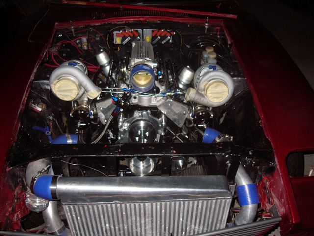

rytherwr Posted January 2, 2009 Share Posted January 2, 2009 Hey folks, Happy New Year!! Been a while...for those who don't know, I hurt my 454 small block at Reynolds last March. Rebuilt it and put it in the barn for a future project. You're looking at my new motor for the z-car...same turbo system, however, motor is specifically built for turbos. 415 cu in sbc, 8.7:1 compression, AFR 220 cc intake runner heads, Jesel 1.65:1 shaft rockers, 3/8, .120 wall pushrods, JE custom pistons, 6" forged rods, forged 3.875 crank, small, short-duration roller cam and lifters,ported Edelbrock Pro XT intake, 96 lb/hr low impedence injectors, Electromotive distributorless ignition and ECM, Alcohol injection, etc. Switching from the Powerglide to a Turbo 400, running 355 gears. Hope to have it together and tuned by the end of Jan and sorted out by the time we get to another SEZ...) Wayne Quote Link to comment Share on other sites More sharing options...

rytherwr Posted January 19, 2009 Author Share Posted January 19, 2009 These are the latest pics from the project as of tonight. Coming together...got the bottom end pretty much buttoned up. Working on the top end putting everything back together and checking fitment. Davy..you've planted the seed now...not making any changes right yet, however will keep an eye out for E85. Quote Link to comment Share on other sites More sharing options...
