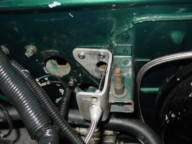

I have also included a picture of my bracket that is fitted to the firewall in case it helps others with their ideas...

here is mine.
It is a Lokar cable hooked up to the stock bracket with a small bracket added to attach the cable.
If you want to see it in a close up, go to this link and double click the photo to supersize it.
