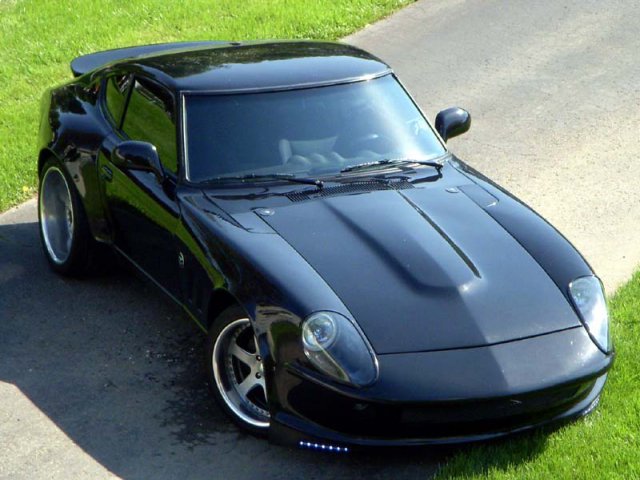

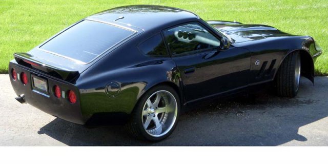

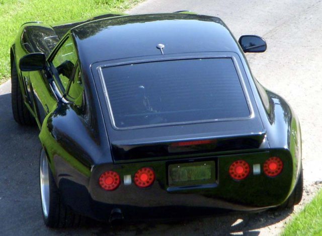

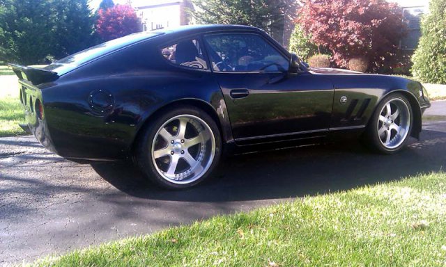

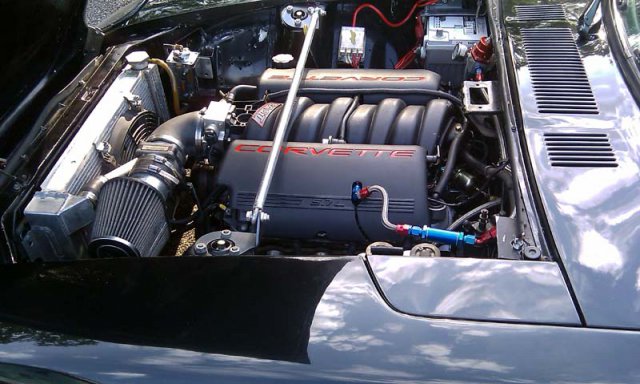

The body work has SOOO many small details... Notice the fuel filler door, the shaved gutters and emblems, hand made airdam, custom blinker cones just to name a few... start looking you'll start to see a bunch of things. I like the fact that if they're not apparent and hard to pick out then it usually is an indication that they were executed well. The rear fenders are the 280YZ's with fender lips to match the front, Subtle Z front fenders and everything else was hand made one off kinda stuff... The doglegs are custom to blend back into the body etc etc etc - haven't even mentioned the rear yet. Those are Boze 18 inch custom wheels. Look around it's all "Stealth" <grin>
Here's a short video of a shake down run... autoX.wmv
Hey all, I thought I'd share some pics of StealthZ. My Dad and I did all the custom Body Work... see if you can pick out all the custom "touches" that are subtly done to almost every panel on the car - Have fun - enjoy - Sorry the pictures aren't the greatest - professional photo shoot coming soon... Rags and Clive installed the LSX driveline... Car is located in Toms River NJ Owner Is a member here - Chas - pipe in if you'd like
