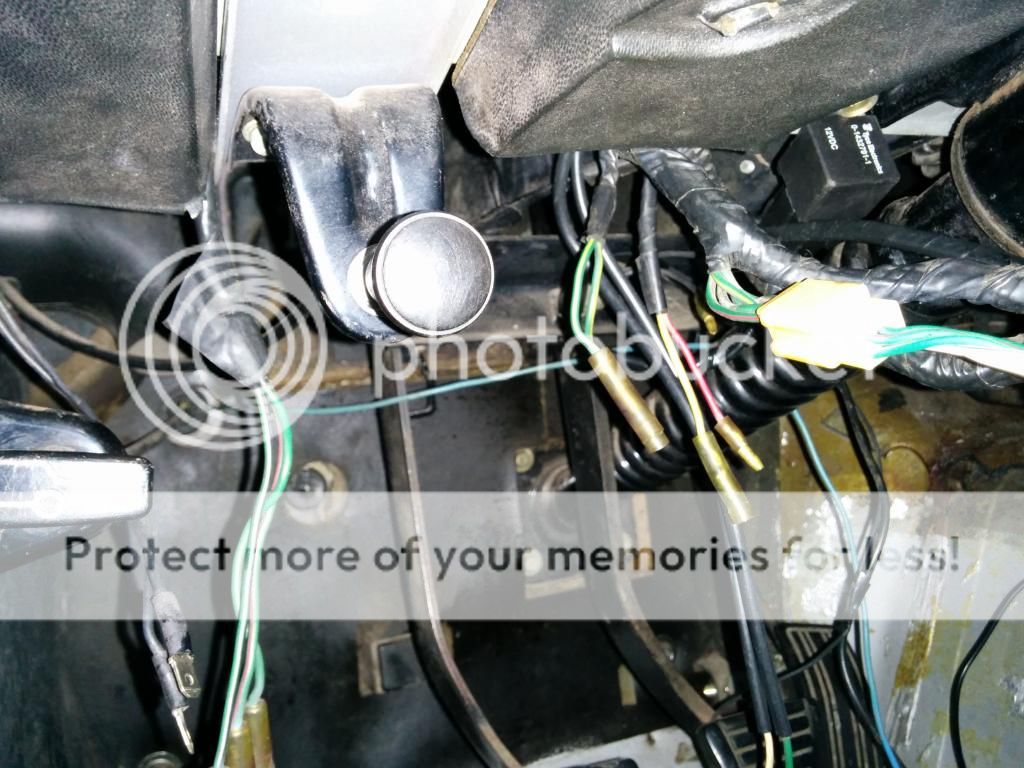

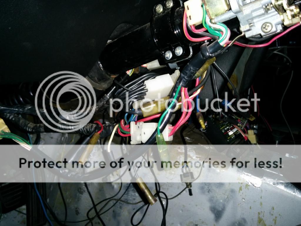

rossman Posted September 16, 2014 Author Share Posted September 16, 2014 (edited) Axles finally complete, Dash is in, wiring is a mess! My house is for sale and is supposed to close mid-October. I would love to drive the car to my new apartment rather than have it towed. I need to get the car again running soon! Missing a few straps but you get the idea... I'm trying to figure out where all these bullet and spade connectors go: Edited September 16, 2014 by rossman Quote Link to comment Share on other sites More sharing options...
