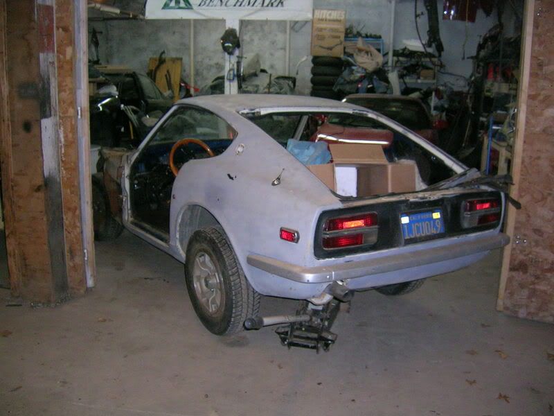

I bought this car 2 weeks ago in Sutton, MA from a craigslist ad stating it was a California car that has been sitting in his garage for the last ten years. Well upon arrival and a few minutes of investigating that claim was bull$hit. It was originally a Cali car 20 years ago but 20 years of New England changes that easily.
The good news about this car is that is complete and a matching numbers car.

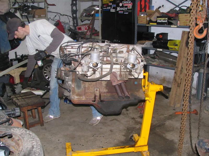

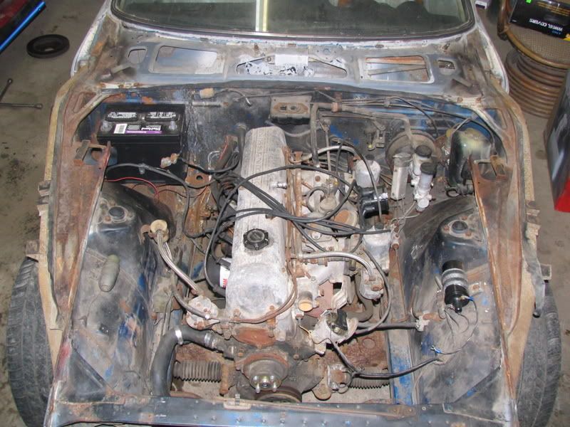

My buddy and I went to the garage last night to do a little work on the Z. I changed the oil and filter. We were able to remove the AC compressor pulley from the front of the crank with the socket that John (my buddy) machined down at work. Once the pulley was off we could see if the engine was seized. The engine turned over with ease!!!! I decided to get the front of the car in the air so we could inspect the years of hacking and boy did we find a lot of ♥♥♥♥ I never expected.

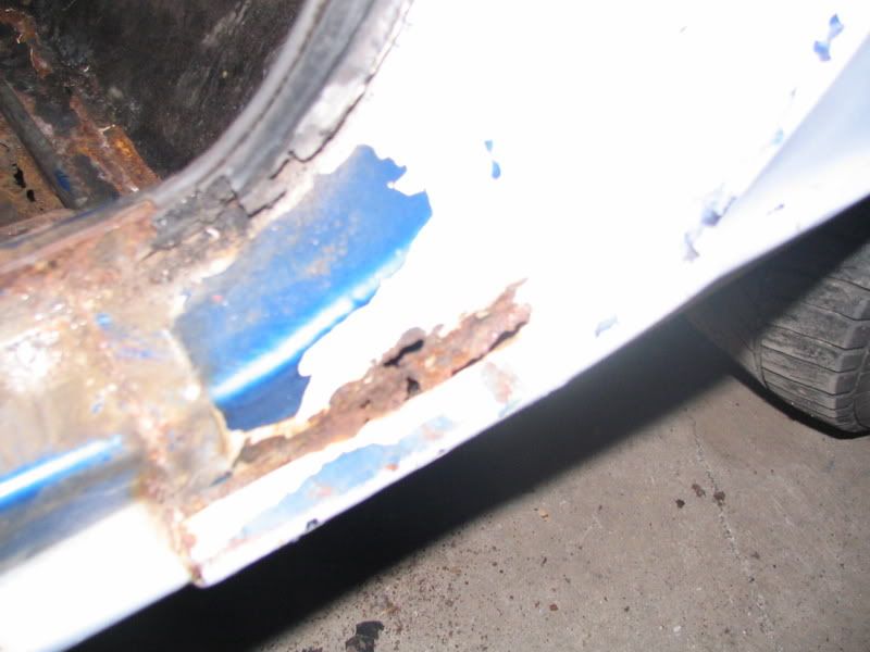

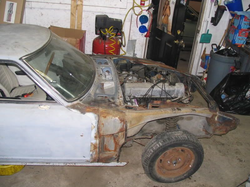

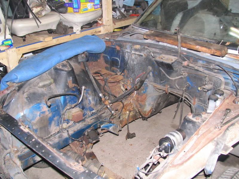

What I saw was a piece of nifty angle iron bolted with 10 3/8” nuts and bolts along the rail. This occurs on both sides. I have no clue why they are there but for some reason I failed to see them when I bought the car. You can also see in this picture the severely rotted and poorly fixed floor pan. This is the one of the areas that is bad that I did know ahead of time. This will be replaced with a new floor pan. Now to the most disappointing thing that I didn’t know was wrong because I was blinded with excitement from owning a 240z (that I have wanted for sometime) .
You can see here someone tried to do some sort of disgusting repair to this support. All my hopes of driving this car around this summer went immediately out the window when I realized how much work is going to be involved. I still believe that I paid too much for this car. If I left my excitement at the door I am sure that I could have walked away with this car for $500 if I called the PO's bluff. I didn’t because I wanted the car so bad.
I think you just described my 240z purchase to a T. From the paying too much, to once being a CA car, down to all the rust problems that come with being in the NE for 25 years (in my case), as well as buying it anyway because of the excitement of being a 240z owner, and even the bad repairs, although mine had different repairs.
Be thankful that your car is actually salvageable. Mine is in MUCH worse condition, and I (stupidly) paid $300 more. Granted, I didn't know what I was going to find, even with what I could see in the guy's garage, which wasn't doing the car any favors.
Anyway, good luck with your project! The car actually doesn't look too bad.
Edit: Actually, now that I look at it, it's really not in bad
Hey that doesn't look so bad. yeah it's going to be some work. but really it looks like a lot of that rust is just surface rust. though the floorpans look really iffy. The Engine turning over is good, you might just get lucky. I've heard you could just spray a bunch of WD40 in the cylinders let it sit over night, change the oil and try to give it a start. who knows though, there could be gunk in the oil passages.

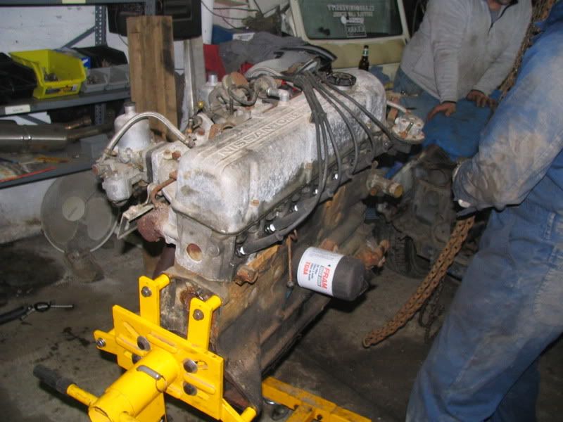

Well Friday night I was hoping to get the motor running so I can start the tear down but I found out I have a bad coil. I did copression test it and all the cylinder are running between 155-185 psi except cylinder #1 which is at 90 psi. I am hoping that it is justy a stuck valve after stting for 10 years that will free up after a little marvel mystery oil. I will be going down tonight to put in the new coil. I might even starttaking off the nosse or the interior. I will def. have pictures for you later.

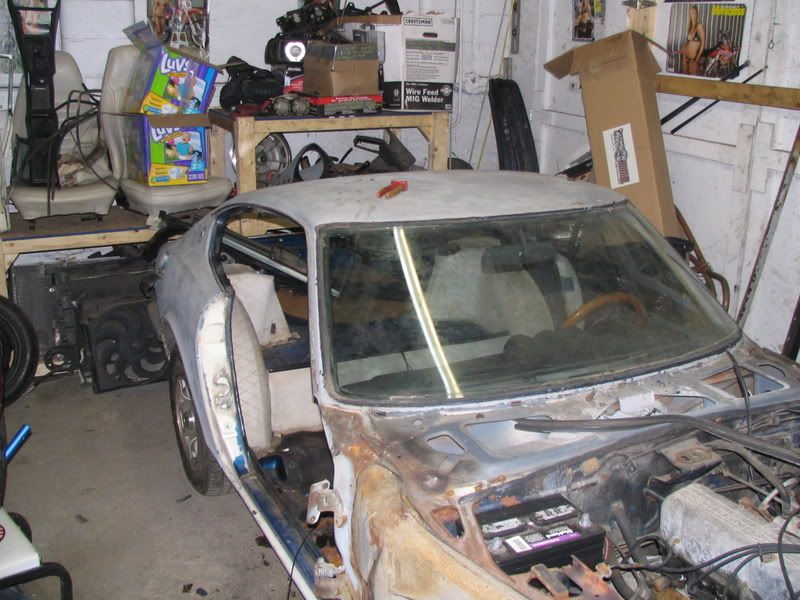

It has been a while since I made an update. I have been able to get some more time in the car and now I am reay to start tackling the body work.
A little more rust...
And a little anger management on a 3 series Bimmer we are stripping!!
