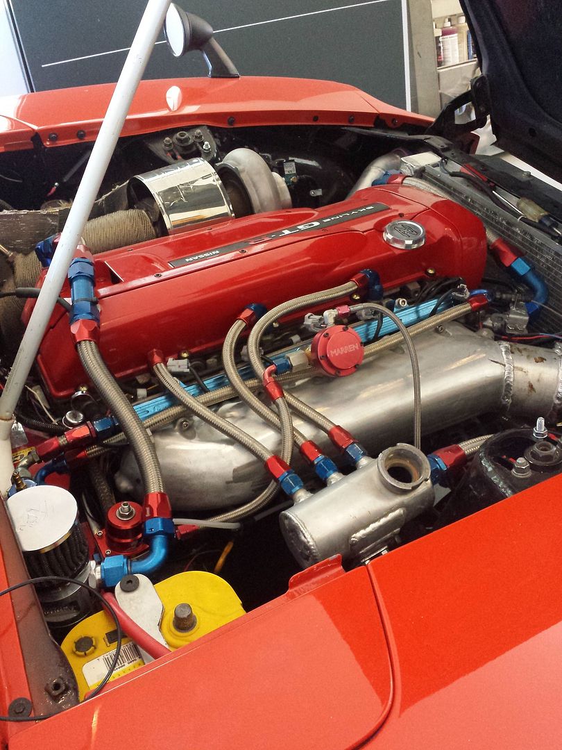

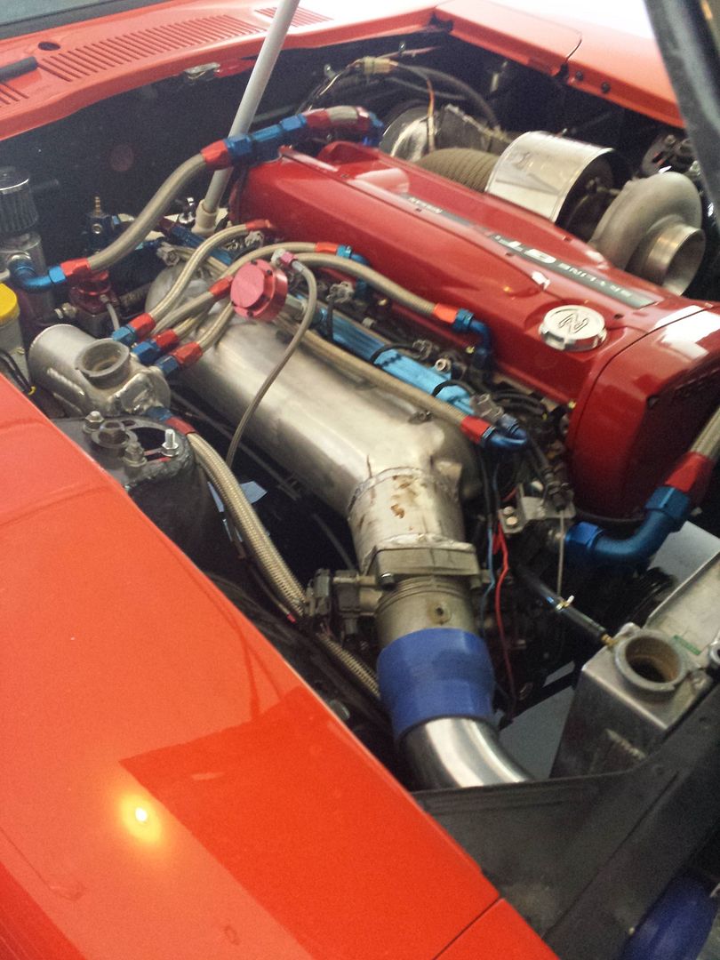

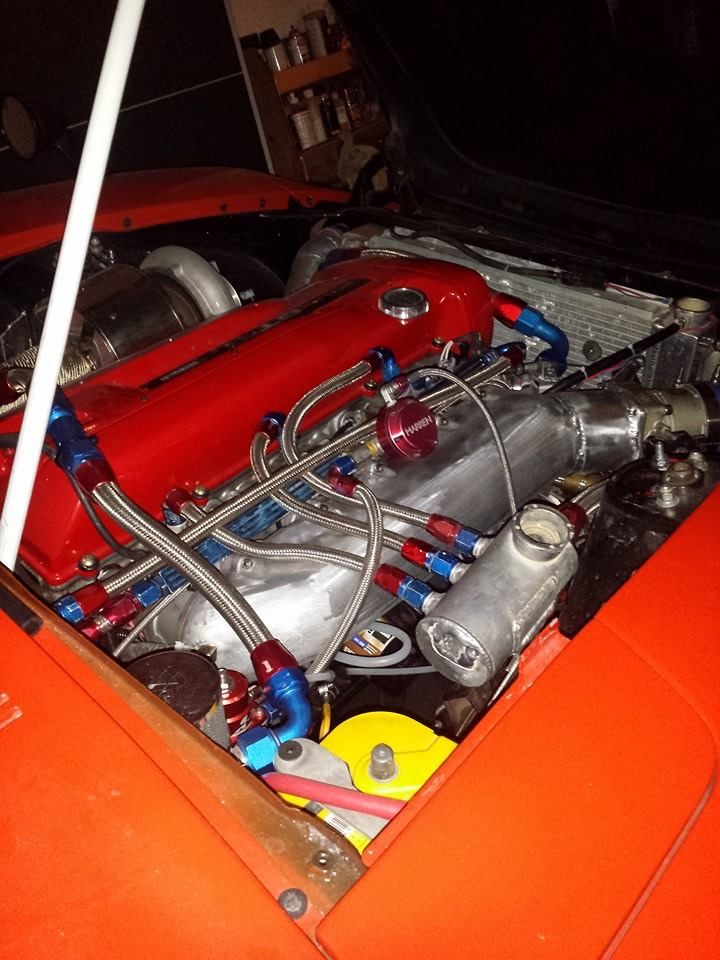

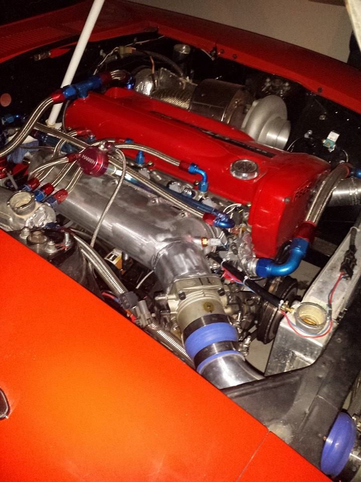

stony Posted June 11, 2014 Author Share Posted June 11, 2014 Only have to tap for brake booster and IAT sensor and weld on throttle cable bracket and its done again ;> I actually really like the way this manifold looks over the last one. If you search rb26 intake manifold and sort by cheapest. the first 3 or 4 that come up are the one i got. US in stock is what is in all the pics. there is one right now for 165.00 Quote Link to comment Share on other sites More sharing options...

flatrate Posted June 24, 2014 Share Posted June 24, 2014 How do you like that intake manifold? I'm sick and tired of tuning ITB's with 2000cc injectors. Does it seem to have any different power band characteristics? I have the same manifold now but i'm using it with the OEM ITBS, just kinda nervous about how short the runner length is if i were to copy what you did. Did you ever flow it like you had mentioned? Quote Link to comment Share on other sites More sharing options...
stony Posted June 24, 2014 Author Share Posted June 24, 2014 NO I have not flowed it yet. haven't had a real good run yet because of the tranny issues. will do that over the winter if I get motivated ;> But up to now I haven't noticed anything different. But keep in mind my old manifold was a stock manifold that had the endtank cut off and a new one welded on. the runners were the same length as the one I have now. This intake was originally designed as a bolt in replacement for a stock manifold with ITBs. Quote Link to comment Share on other sites More sharing options...

stony Posted July 24, 2014 Author Share Posted July 24, 2014 Manifold all welded up. the bolt together version couldnt handle the boost. New go fast update. Quote Link to comment Share on other sites More sharing options...
flatrate Posted July 25, 2014 Share Posted July 25, 2014 You blow the manifold apart? I welded a throttle flange on mine just like you did except I gutted the ITBs and kept them in the mix for runner length. Quote Link to comment Share on other sites More sharing options...
