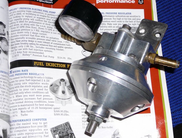

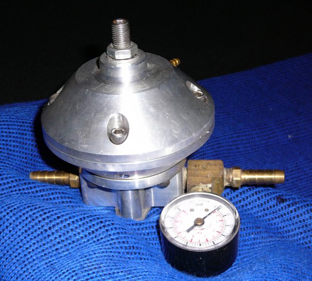

Nelsonian Posted March 7, 2009 Share Posted March 7, 2009 WigenOut-S30, I have a lightly used MSA adjustable fuel pressure regulator that might be a consideration for your use. I would like to get $100 for it. If your interested shoot me a pm. Quote Link to comment Share on other sites More sharing options...
