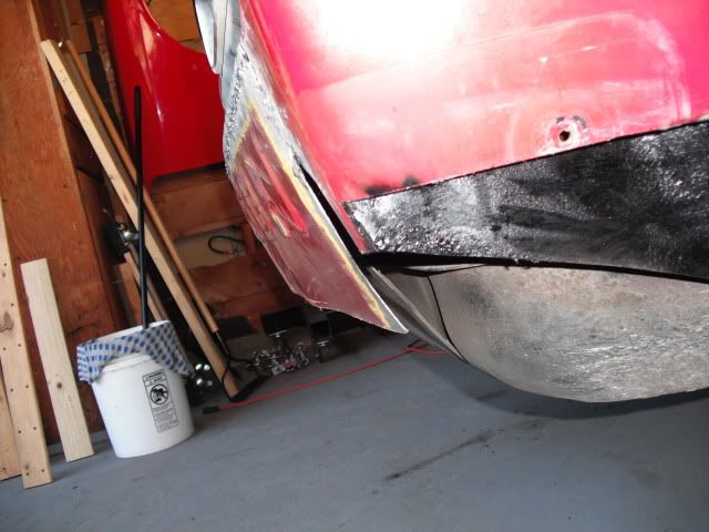

Beau M Posted May 27, 2009 Author Share Posted May 27, 2009 Nope, went to Vegas last week. I need to get a new passenger side lower rear quarter, and figure out WTF I am going to do with the lower edge of the panel. I will take some pics of it tacked in tonight though, it will give you an idea of what it will look like. Quote Link to comment Share on other sites More sharing options...

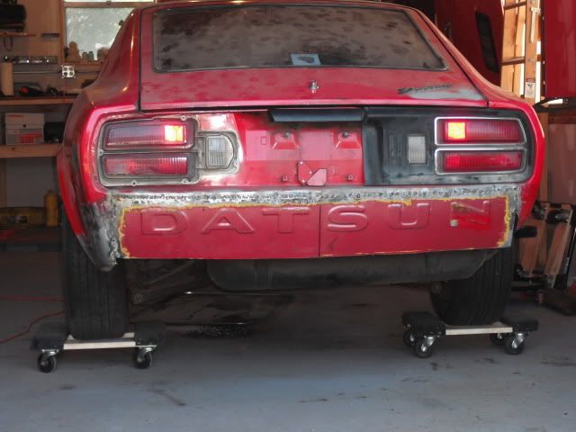

Beau M Posted May 28, 2009 Author Share Posted May 28, 2009 OK, let me re-state that I am by no means a competent fabricator. I'm just learning to weld, and have never done any body work like this before. It's going to need some filler to make it look good, but its going to be all metal behind. As you can see I need to finish the passenger side and figure out what to do with the lower edge of the Datsun panel. The driver side rear quarter is a Tabco coupe piece I modified. Any ideas? Constructive criticism? Quote Link to comment Share on other sites More sharing options...
Valmont Posted May 28, 2009 Share Posted May 28, 2009 man that is so frickin awesome. I know zero about welding, but isn't there anything you can do with heat to help you curve the metal? Maybe it only applies to smaller stuff, but i thought you could use it to constrict. Also, what are you plans for exhaust? I picture two tips at least? Quote Link to comment Share on other sites More sharing options...

cockerstar Posted May 28, 2009 Share Posted May 28, 2009 That's it. I'm doing it this summer when I shave my rear bumper and side markers! I have had a bit of experience - dogleg patch and a sunroof patch You're doing great for this being your first time Beau Get a large piece of copper to place behind the seam as you stitch weld. It will help dissipate the heat of the weld, and it also provides a backing to help build up filler. Quote Link to comment Share on other sites More sharing options...

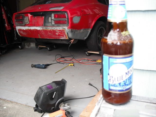

Beau M Posted July 7, 2009 Author Share Posted July 7, 2009 Slowly but surely.... Quote Link to comment Share on other sites More sharing options...
SoCalJack Posted July 7, 2009 Share Posted July 7, 2009 Wow!!! That looks awesome. Keep up the good work! Quote Link to comment Share on other sites More sharing options...
