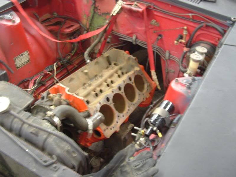

OK, people I have a 72 240Z that I am doing a SBC swap with. I also happen to have an extra empty 350 block for my mock-up work. I did bolt an oilpan on the block so I could see just where things would be. I only wish I had an empty transmission case.... That's a heavy part for playing with.
So, tonight I started with just the raw block with oilpan and the stock motor mount plates for the 350. I set the 350 mounts over the Z frame rail mounts and let the motor rest on those points up front. Then took a strap and hooked it around the hood latch for holding up the back. This also let me raise and lower the rear as I wish.
I was very shocked at just how close it was with just doing this.
Then after some playing around and looking I pushed the transmission under and got it bolted onto the block.
Now as I looked over the info on the JTR kit and parts they talk about set back plates. I dont understand why you would go back. The only reason I could thinkof was for fan clearance. But, If I was to bring the whole package forward just 1" or 2" It would clear up many more of my headaches. One thing that would do is put the tail of my transmission within reach of building a mount that could use the stock trans mount of the Z. It would also help me with clearance for the shift linkage on the transmission and the trans tunnel on the Z. If you look at the underside shot you can see the linkage touching the tunnel. Now keep in mind the whole package will raise another good 1-2" with motor mounts on. So pushing it back would only make it worse. Also, going forward would give me clearance for keeping my stock hood latch. Now I have plans on electric fans for cooling and an electric water pump aswell. So I do have the room for pulling it forward the 1-2" I just mounted a stock waterpump so I would have alittle gauge for now.
Anyway, Would this be throwing off balance? Or are there other reasons for setting the motor back vs. forward. I am not looking for a 1/4 mile car here. Just a fun street car.

Thats what I was wondering about. I wasnt sure if it would throw it off that much or not. Now I see I was thinking correct with where the motor would sit by how your balancer is over the rack. That was my guess of where it would end up after mocking it up.
Nice job, how did you deal with the transmission clearance on the shifting linkage? After looking it over tonight I think thats about my only real issue with setting it back. Other then that it looks rather cut n dry.
The main issue with the motor that far forward is getting the exhaust around the steering shaft. Damper to rack clearance is also an issue.
You basically have three variations mounts you can purchase, hooker, msa, and jtr. The hooker is most forward and uses the hooker headers, the jtr is most to the rear, the msa is in between. Msa and jtr can use S&S headers or block huggers. The exhaust is the most problematic part of a V8 Z IMO.

With the hooker mounts and headers, you don't have to cut out the hood latch. With jtr, you've got to cut out the 45 deg part to clear the distributor. I'm not sure about msa.
The hooker mounts position the motor pretty high, and air cleaner clearance is very tight. You see a lot of hooker cars with the little foam air cleaners on them.
I use the jtr mounts because you can wind up with an almost 50/50 F/R weight dist, about 52% on the rear with me in the seat. I do road race track days and time trial my car, so handling is important. With the hooker setup, you're probably going to wind up 54 -55% on the front. It's not the end of the world, but it's not optimum for handling. For a nice street car, it probably wouldn't be an issue.
There are a good many compromises made in a project like this. Set your priorities and name your poison.

Depending on your motor/trans selection dictates how much you need to massage your tunnel. I have the LT1 with the T56 in a 280Z and had to do very little tunnel massaging.
Check out my pics in my gallery. You can see how much of the original tranny mount I cut out with a SawZall. I didn't have to move the hood latch because of the Lt1, But even though with a Distributor there you can cut away the 45, move it over with the JTR plate, or eliminate it and use hood pins where the bump stops are.

I have a feeling that I am looking for the Scarab motor mounts, hooker, or I am just going to end up building my own mounts. Between the cutting of the hood latch and just how much trans tunnel work the 400 will cause I will keep it forward. I know it's not alot of work on eather job. But once I start cutting into the car any plans I had for going back stock are out the window. I may never go back stock with this car. I cant say 100% yes or no on that. But I do know it's a very nice choice that I would like to have.

with an automatic I would use the forward mounted position (like you have it). Yes, the weight on the nose of the car will be more. But the engine cooling is much better with the engine more forward. The forward position creates a lot more room around the transmission and the transmission tunnel which is the path hot air takes to leave the engine compartment. An automatic transmission almost touches the body in the set back position which restricts the air flow greatly.
if nose weight becomes an issue, then move the battery to the back and get some aluminum heads, intake, and water pump.
I thought the Scarab kit was the way to go until I first drove my car with that heavy V8 hanging way over the crossmember. A lot of these worries about cooling, transmission fit, and header clearance are just not that important. If you want to build a fun street car and not an all out drag racer move the engine back as far as you can. Use aluminum heads, intake, and electric fans. It is lighter than the stock staight six. Take my word for it you will regret not doing so because it will sacrifice the balance of this car. You don't have to go as nutty with your build as some of us but do move the engine back. Good luck bro. Things look really good so far.

I can tell you that in a 71Z, lt1 and t56 if you move the engine foreward you will not clear the steering shaft. I am using Sanderson headers and with the engine set all the way back I clear the streering shaft by 1/8", But you will need to clearance the tunnel on the right side to clear the bellhousing, The JTR kit moves the enguine over and back so it's tight.
