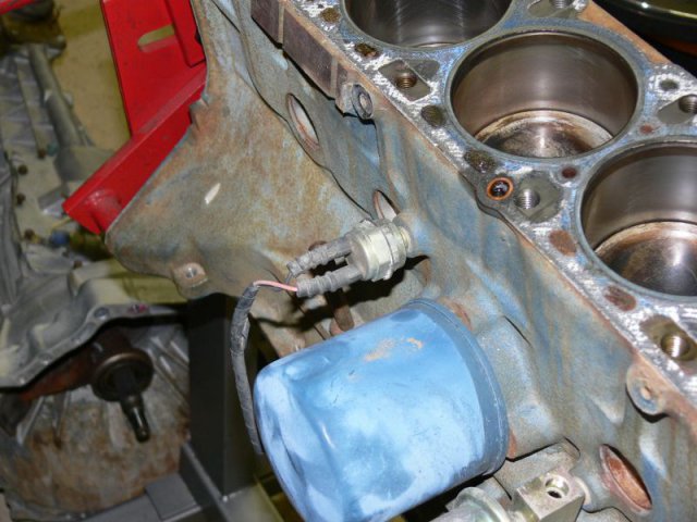

Zmanco Posted April 11, 2009 Share Posted April 11, 2009 Ok, I'm finally taking the plunge over to the dark side on my 73. I found a deal on an engine and transmission from a wrecked 82 turbo. Interesting story: the car was stolen from the dealer lot and totaled. The dealer removed the engine/tranny/driveshaft and sold it to the brother of the guy I bought it from. It sat in his garage for 20+ years and then when he sold his Z it went out into the field behind his father's home. I picked it up this week with less than 100 miles on it. I've been spending a lot of time searching but there are a few issues I'm just not able to clear up. I thought I'd try asking those questions all in this thread so the next person might have an easier time finding the last bit of information. Question 1: Does anyone have any pictures showing how they mounted the rear transmission mount? I've found a few threads discussing this, but the descriptions just aren't clear to me. The issue appears to be that the center line of the T5 mount is 15 or 30 mm off the stock one, depending on how the T5 mount is oriented. Bryan Little's site talk about using 2 pieces of angle iron, but I think that is only for the early 240s, not for my 73. Question 2: For the BW T5 transmission, what is the proper fluid and how much? I found a book called "How to build and modify your manual transmission" that says the early T5 can use GL4 70w and that later WC T5 use ATF. But I'd feel better if I heard this from multiple sources. Also, I've read the amount is 2.7 - 2.8 liters. Does that sound right? I had planned on going with Redline MTL until I read the passage in the book. Question 3: I know I need to shorten the drive shaft. I currently have a 4.11 R180 diff with CLSD that I would like to keep. I understand I need to find the special diff flange from the turbo R200, but need to confirm if it will fit the R180? Question 4: I've read the diff sticky over and over, but don't see anywhere that specifically says if the R180 is the same length as the R200? Or maybe I should really ask if the R180 and R200 both can use the same length drive shaft? I ask because if they're not, then if I am going to swap to an R200, I should do it BEFORE I shorten the drive shaft. I'd rather not change its length twice. Question 5: What is this sensor near the oil filter? Perhaps a switch to sense low oil pressure? That's all so far, I'll have more as the build progresses. TIA. Quote Link to comment Share on other sites More sharing options...
skib Posted April 11, 2009 Share Posted April 11, 2009 Zmanco said: Question 5: What is this sensor near the oil filter? Perhaps a switch to sense low oil pressure? Knock sensor Quote Link to comment Share on other sites More sharing options...
Zmanco Posted April 11, 2009 Author Share Posted April 11, 2009 skib said: Knock sensor Wow, I didn't know that the turbo Zs had knock sensors. I'm running MSII/Extra which has support for it. Hmm... I wonder if I can begin to use that feature? Cool. Quote Link to comment Share on other sites More sharing options...

josh817 Posted April 12, 2009 Share Posted April 12, 2009 Yah thats a knock sensor, I think on a P90A head its in the block and there is a sensor at the rear of the head which is cylinder head temperature. Quote Link to comment Share on other sites More sharing options...
