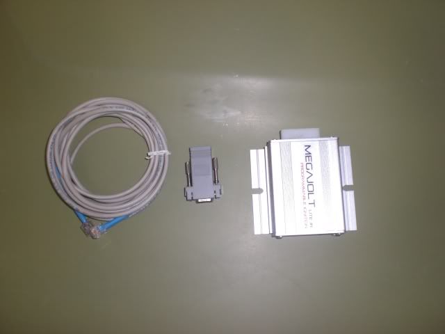

josh817 Posted April 25, 2009 Author Share Posted April 25, 2009 Megajolt system. I already bought one and built it. I chose TPS over MAP since I did the port work myself on this head and I doubt all the ports match, plus a moderately radical cam. I see MAP systems on race cars though which run crazy cams and they have a conversion setup to turn my TPS into a MAP. The board has a spotmark for tps components and another spot for map so I't probably as easy as cutting a trace to the TPS and installing the MAP components if I wanted too. I didn't buy the system to have my own advance setup though, the idea was to have an accurate spark at the higher rpms, rev limiter, ability to change my timing but not make the curve dead on (otherwise I would go ahead and convert over to MAP), and Megajolt provides like 3 or 4 ports for 0-1V inputs plus a 0-5V input. Wideband sensors are 0-5v's :] and the system allows you to log data so I can record a wideband reading along with my ignition and rpm's. I have a knock sensor from the old motor and I'd like to install that too but it needs to be 0-1v and I have no idea what the output of a knock sensor is. If it is 0-1v then that means I can setup like an advance correction so when the knock sensor "feels" something the timing will retard until its gone. I'm so stoaked about it! Maybe once I figure all this stuff out I can gain the confidence to try out FI. The whole idea of this motor was to avoid massive wiring and all that stuff I never understood about MS. As for the front cover, I think the seal around the damper will be fine as long as I don't wrestle with it. Which I probably will... I'll tap it out with a mallet and do the same when I put it in. Radiator will need to come out and I guess at this time I will pull my oil pump and take it apart to redo the gaskets. I used this blue-ish clear adhesive thats like jellow when dried and its doing a horrible job with it dripping every now and then. PS: So I'm doing body work today and guess what I found in my passenger side dog leg... yes, obvious rust through the other side and I don't have the equipment with me at home to fix it properly so I did a nasty nasty thing. Dynaglass the entire hole, shame on me. My punishment was getting it all over my hands and it wrestling with the crap. However thats not the surprise! I found a rock, in the dog leg, which is almost the size of my palm. The dogleg didn't have a hole big enough to fit it through so obviously rust has globbed together to make a massive Datsun tumor. Perhaps this is the typical Datsun rear end clunk. Quote Link to comment Share on other sites More sharing options...

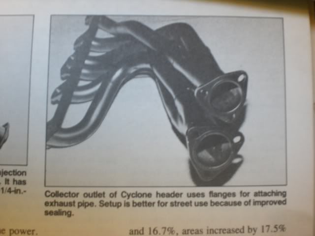

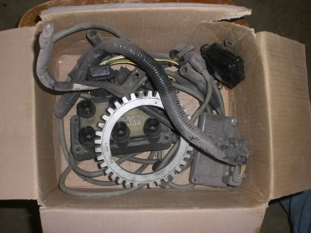

josh817 Posted April 25, 2009 Author Share Posted April 25, 2009 :/ I don't have the money for billet otherwise I would go out and buy Derek's mounts. I saw a dude who used a big 1/4 or 1/2" square steel plate. It worked for him but looked funny. I can see flat strap wobbling, there has to be something between the two thats affordable for me. PS: New problem, Dynaglass will not feather in nicely. Visually it looks good but you can feel a tiny transition between primer and filler. I have tried 500 grit and still nothing. :[ Today is not my day. EDIS-6 with Megajolt, I will not be getting new spark plug wires or anything like that. If these reach the way I want them too then its alright. Headers I was talking about in first post. This is from How To Modify Your Datsun/Nissan Engine, I do believe. The paint, oh and I also wet sanded the entire car just a real fast sweep over with 220 even though the instructions say don't sand the first coat of etch primer, there was some dirt in there: Hood before I sanded: After I tried feathering the edges, there is still that little blip. Maybe I try a palm sander or am I being too anal? The primer feathers real nice, Dynaglass, unless thats feathering, does not. Surprise!!!!! Datsun confetti with Datsun rock! Not to proud of what I had to do...: :/ Quote Link to comment Share on other sites More sharing options...
