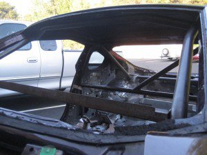

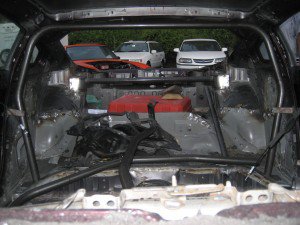

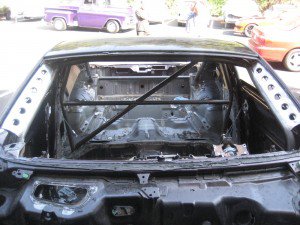

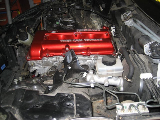

SR240Z Posted May 8, 2009 Share Posted May 8, 2009 Yes this is for real! We are in the midst of building the roll cage for our 350z to Formula D rule standards. The car is going to primarily be a competition drift car which I (Alex) will be driving. I will be documenting progress on http://www.AlexVillabrille.com as well as through this thread. I was able to get some semi-sponsorships to help with the build from JustDriven.com, M1 Autosports, and Dynamic Autosports. Attached are some teaser shots for your viewing pleasure: Quote Link to comment Share on other sites More sharing options...

SR240Z Posted May 8, 2009 Author Share Posted May 8, 2009 Were doing the sr20det because we already have a completely built and proven drivetrain from our 240z. The setup has never ceased to amaze us and will make the engine bay relatively easy to work on in between events and maintenance. Austin: Im not sure on the weight differences since we dont have an engine hoist scale but the VQ is a very stout motor. Quote Link to comment Share on other sites More sharing options...

AkumaNoZeta Posted May 8, 2009 Share Posted May 8, 2009 And I always thought of them as heavy pigs because they came from the factory at what? 3300lbs? When I looked at the picture of the SR in your engine bay my jaw dropped because I couldn't believe how much extra room there was in there, I really like that. Quote Link to comment Share on other sites More sharing options...

SR240Z Posted May 8, 2009 Author Share Posted May 8, 2009 Thanks for the compliments guys. I don't have my license yet but from a few practice events I've gotten really good feedback from fellow drivers to go out and get my license. As of right now the cage is all tacked in... our roll cage guy just has to make the door bars and then do all the final welding. Quote Link to comment Share on other sites More sharing options...

Young Z Posted May 9, 2009 Share Posted May 9, 2009 that sr looks like it would be very easy to work on as you said, very clean install. How long have you been drifting for if you don't mind me asking? If you good enough to try out for a FD license after only driving a few times then you must be a drift prodigy! can't wait to see some pics of this going sideways. Quote Link to comment Share on other sites More sharing options...

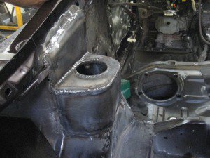

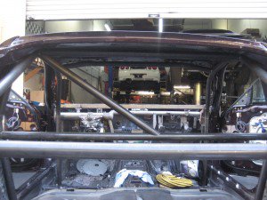

SR240Z Posted May 9, 2009 Author Share Posted May 9, 2009 Grim: Well the VQ is just sitting in the corner of the shop (Complete engine with all accessories, complete harness, ignition and ECU... No trans) I want to sell it but prices for VQs have gone way down and its not even worth it really. It only has 16,700 miles. Most of the cage is all tacked in... tomorrow just need to do the door bars and finish all the final welding. Here is the progress from today attached: Quote Link to comment Share on other sites More sharing options...

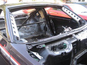

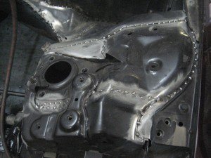

SR240Z Posted May 9, 2009 Author Share Posted May 9, 2009 Cage is almost completely finished... The front gussets were done, entire cage is completely welded and ready to rock except for the door bars. Doors bars are already made and ready to be tacked on and welded but we ran out of gas today Here is today's updates: Quote Link to comment Share on other sites More sharing options...
