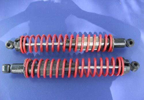

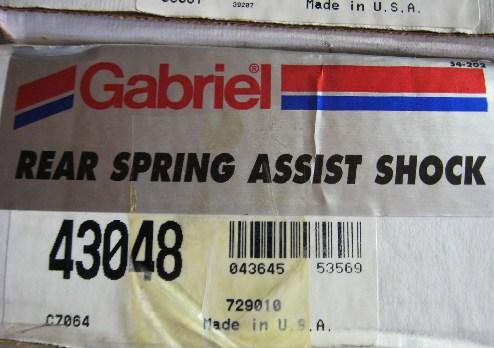

260ZRED Posted June 9, 2009 Share Posted June 9, 2009 jc052685 (Jeff) is 110% right, I've been with him for many towing trips and you want to do EXACTLY what he suggested. ESPECIALLY if your towing vehicle is small. Another option to consider is load adjusting shocks - see pics. I have about 50 pairs left in stock and they do fit your Nissan Pickup. PM me for more details if you like, I will get you those shocks for less than $70 per pair, SHIPPED. =) -Igor Quote Link to comment Share on other sites More sharing options...
