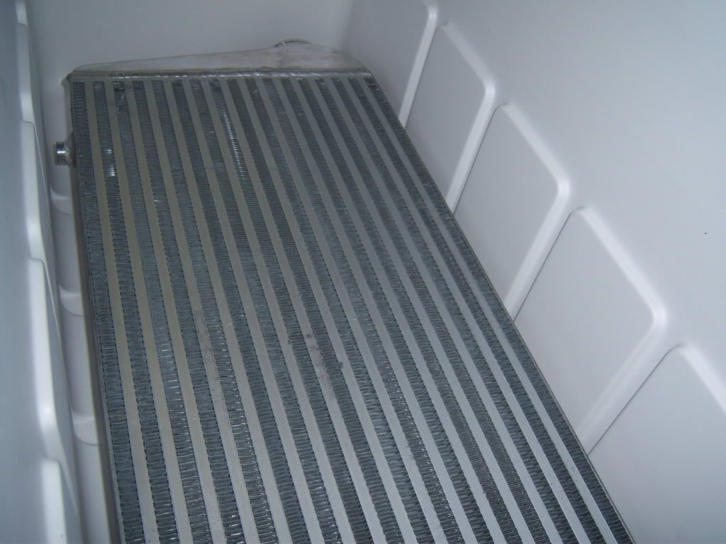

a6t8vw Posted May 30, 2009 Share Posted May 30, 2009 good for track? filled with ice/water with a re-circ pump.. this IC is the 4" core big one. 150qt icechest. i might go ahead and try this, it will be properly secured and all that. . . . Quote Link to comment Share on other sites More sharing options...
AK-Z Posted May 30, 2009 Share Posted May 30, 2009 Haha. I think you have better efficiency with a smaller IC if you want to go water cooling. But you work with what you got. You also have to remember. power to weight. Is all that water/ice worth the power you would get, I can see it would be better for endurance. Quote Link to comment Share on other sites More sharing options...

a6t8vw Posted May 30, 2009 Author Share Posted May 30, 2009 Haha. I think you have better efficiency with a smaller IC if you want to go water cooling. But you work with what you got. You also have to remember. power to weight. Is all that water/ice worth the power you would get, I can see it would be better for endurance. im going land speed racing so weight isint an issue, actually more the better... and im looking @500-800hp so it wouldnt slow me down ..lol Quote Link to comment Share on other sites More sharing options...

WizardBlack Posted June 5, 2009 Share Posted June 5, 2009 It would probably work better with an actual air/water intercooler instead of an air/air intercooler. Quote Link to comment Share on other sites More sharing options...
(goldfish) Posted June 5, 2009 Share Posted June 5, 2009 It would probably work better with an actual air/water intercooler instead of an air/air intercooler. I would tend to agree, but I assume you are work under a tight budget and time frame? Quote Link to comment Share on other sites More sharing options...
a6t8vw Posted June 6, 2009 Author Share Posted June 6, 2009 It would probably work better with an actual air/water intercooler instead of an air/air intercooler. why? only thing i see is the pressure drop is greater than a a/w core... Quote Link to comment Share on other sites More sharing options...
Tony D Posted June 6, 2009 Share Posted June 6, 2009 Converting a core to water/air is not that difficult and there likely is some efficiency in actually flowing water over the I/C cores to carry away heat into the thermal mass. Then again, putting an external water pump (Like the Bosch Water Pump for the Ford Lightning I/C setup) to a sparger tube under the 'radiator' side of the core and tapping off the bottom of the cooler would probably impart more than enough water flow over the core to make it for all intents and purposes just as efficient an intercooler. Likely with an Air/Air Core at the front of the car to drop some BTU's out first, the one in the water chest will result in more than perfect intercooling, and more than likely make for air considerably cooler than ambient going into the engine. Denisity is your friend! I have seen an L-Engine setup where the turbo went to an Air/Air up front, and then went through a supplementary Paxton Air/Water unit just before the throttle body. Through the Paxton unit, there was a water wetter/water mix circulated from a 21 Qt Dry Sump Tank mounted near the Right Rear corner of the car. The Dry Sump tank would be filled with water/waterwetter and ice. Air densities (especially on dyno runs) were quite interesting! F1 cars in the 80's actually used I/C bypass systems to keep the air at a standard density for proper fueling and fuel atomization. On one make, they needed a 130F intake air charge in order to keep their fuel in a light viscous form---any cooler and they would have 'fuel' that acted like sprayed syrup! Stationary engines also use thermal control to the intercoolers to make for consistent air inlet temperatures regardless of ambient variations/fluctuations. Quote Link to comment Share on other sites More sharing options...
WizardBlack Posted June 6, 2009 Share Posted June 6, 2009 why? only thing i see is the pressure drop is greater than a a/w core... Any way you slice it, AW intercoolers are different than AA intercoolers. There has to be a purpose behind that. Most likely efficiency of heat transfer between the water side and the intercooler. Quote Link to comment Share on other sites More sharing options...
Tony D Posted June 7, 2009 Share Posted June 7, 2009 Really the only effective difference I have noticed is that they jacket a standard core and make a multi-pass water flow through a standard Air-Air core. Take a good close look at the photo 510 Six posted, and the larger Eclipse unit looks to have been just that. Having seen them making up the Ford Lightning Prototypes at Garrett R&D, this is more than truthful as to what the end unit looked like. Really, the mose efficient method for doing it is to flow the water through the AIR side of an Air-Air cooler, and then flow boost through the core in one pass...but with much thicker core (think like an A/C Condenser). These people aren't making dedicated water-air coolers, in most cases they just jacket the air side and pass the air through where it already went. Paxton flows through the tubes I believe, but when you knock it down...without the jackets you can use it either way. Thermal Transfer makes most of the Intercooler Core Blanks for general industry and is an OEM supplier for most of the automotive truck brands. When you start looking around at their offerings, most are not dedicated water cooled exchangers (multi-pass air flow over tubes) simply because mobile installations do not permit the space for mounting those kind of coolers. So they take what is normally sized for the application and make a water jacket for it. Quote Link to comment Share on other sites More sharing options...
