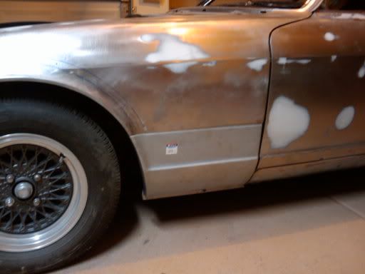

wearetheromans85 Posted June 7, 2009 Share Posted June 7, 2009 hi, been workin on strippin these front fenders from my 260z but i dont know if this damage/rust is repairable. i dont want to continue working on these if im just gonna need to get new ones. anyone? http://i43.tinypic.com/2mezqbr.jpg http://i44.tinypic.com/2wp2p8o.jpg http://i42.tinypic.com/2a0n5oy.jpg http://i44.tinypic.com/2mcsylc.jpg Quote Link to comment Share on other sites More sharing options...
JMortensen Posted June 7, 2009 Share Posted June 7, 2009 I would fix them. I had rust (although not that bad) in the same spots. I cut a large section out and welded in some sheet metal. The tough part is where the metal is folded over on the edge. You pretty much have to just keep cutting until you get rid of the rust, then make yourself a panel. I think Tabco might have patch panels for that part of the car, but I just used flat sheet because there isn't much going on there and it's pretty easy to bend it to fit. Quote Link to comment Share on other sites More sharing options...
wearetheromans85 Posted June 7, 2009 Author Share Posted June 7, 2009 cools. that was what i had thought of doing. do u know what gauge sheet metal those fenders are or which gauge to use? Quote Link to comment Share on other sites More sharing options...
rturbo 930 Posted June 7, 2009 Share Posted June 7, 2009 cools. that was what i had thought of doing. do u know what gauge sheet metal those fenders are or which gauge to use?Pretty sure they're 20 gauge sheet metal. Should be, anyway. Quote Link to comment Share on other sites More sharing options...
Turbo7MN Posted June 7, 2009 Share Posted June 7, 2009 Definitely fixable, to do it properly you will need to un-hem the seam make the proper patch, metal finish, and re-hem it. If you need to learn about metal shaping this site is the best. http://www.metalmeet.com/ Quote Link to comment Share on other sites More sharing options...

AK-Z Posted June 7, 2009 Share Posted June 7, 2009 Just cut out the portion with a dremel with a cutoff wheel leaving the sides in tacked . then grab some card board and cut a piece that matches the hole, and use that to cut and bend a new piece for some scrap sheet metal and weld it in. Quote Link to comment Share on other sites More sharing options...
Wheeler Posted June 8, 2009 Share Posted June 8, 2009 As stated, Tabco does make the patch pannel that you need. i just recieved mine, it looks like a good part, should work well to fix your problem Quote Link to comment Share on other sites More sharing options...
