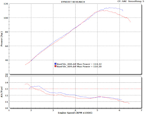

burninator Posted July 2, 2009 Share Posted July 2, 2009 (edited) Over the last few days I've been trying to dial in my car on the dyno. I was doing most of my testing without the air-box on, so no horns attached to the carbs. After I got the car about where I wanted it I attached the air-box back plate (with the horns on it) and I lost power starting at about 5000 rpm. At 6000 rpm it had 9 hp less with the horns than without them. I thought the horns were supposed to help airflow not hurt it. There were no significant gains anywhere in the curve so I'm kinda confused. I think I'm going to remove the horns from the airbox unless anyone can think of a reason not to. Has anyone else done any testing and found different results? Here is the dyno chart: Edited July 2, 2009 by burninator Added Graph Quote Link to comment Share on other sites More sharing options...
MAG58 Posted July 2, 2009 Share Posted July 2, 2009 (edited) Reading an old datsun performance manual I have, they recommended against using both the air horns AND an Air box, as the air horns are supposed to straighten and direct from a relatively open area, while if you add air horns to the air box, the rearward cylinders basically can only get air from the far side from the air box. Take the Air box off and leave the air horns on and you should see your gains. ~Bob Edited July 2, 2009 by MAG58 grammar Quote Link to comment Share on other sites More sharing options...
burninator Posted July 2, 2009 Author Share Posted July 2, 2009 When I did the run only the plate with the air horns was attached. The rest of air box was still off the car. Quote Link to comment Share on other sites More sharing options...

MAG58 Posted July 3, 2009 Share Posted July 3, 2009 Ah, see when i first read this i originally though you had triple sidedrafts, I was obviously wrong. However, from the look of your AF ratio graph, I'd recommend trying some stiffer Dash-pot springs. This may even improve your mileage, as it holds your dash-pots down longer, but it should also be beneficial as the air-horns flow substantially more air than the stock box. Quote Link to comment Share on other sites More sharing options...

Drax240z Posted July 3, 2009 Share Posted July 3, 2009 Did you just have 1 run to confirm these issues? could also be a heat soak issue as I see your later run was the one with the horns... Quote Link to comment Share on other sites More sharing options...

burninator Posted July 6, 2009 Author Share Posted July 6, 2009 Sorry I guess looking back I should have made it more clear. I am running SUs, stock air box, and stock horns. The loss is backed up by multiple runs and is not due to heat soak. I appreciate all the advice, I am the one asking the question afterall, I just didn't think the AFR was different enough with or without the airbox to say a lack of tuning caused it (especially where the power dip occurs). I beleive I have the car as lean as it will go at my altitude (~5000 ft) without getting new needles and/or nozzles I guess I might have to get some to see enough difference in the air-fuel ratio to see a diffence in power. As far as stiffer springs in the dashpots, I was thought it was the other way around. Heavier springs may cause the needle to sit further in the the nozzle, but the air is moving faster and the venturi affect causes it to pull more fuel and actually richens it up. Thats what I read, and I have a few runs to back up this theory. I started out with no oil in the dampers and stock springs, now I'm acutally running it with no springs and ATF in the dampers. I did quite a bit of testing and it did improve the AFR. Thanks for the input. Quote Link to comment Share on other sites More sharing options...
