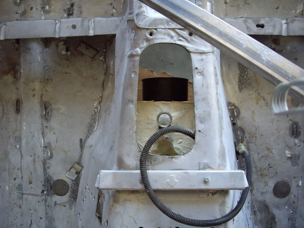

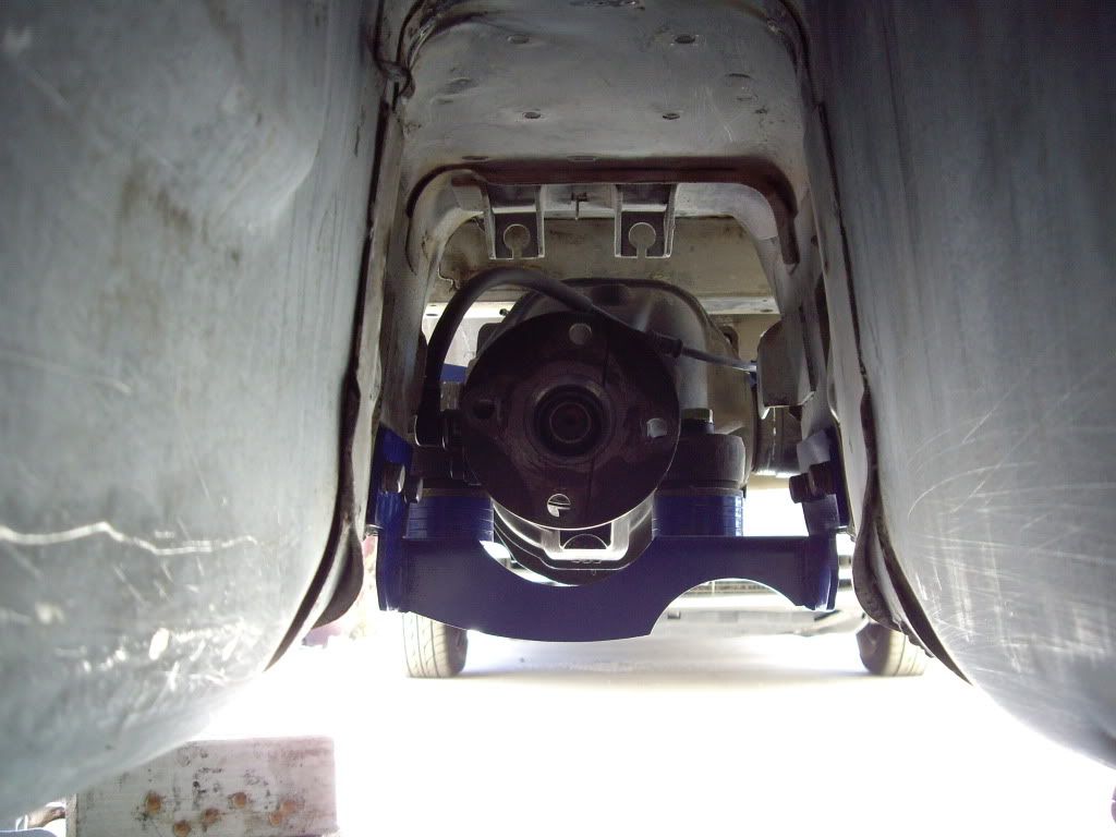

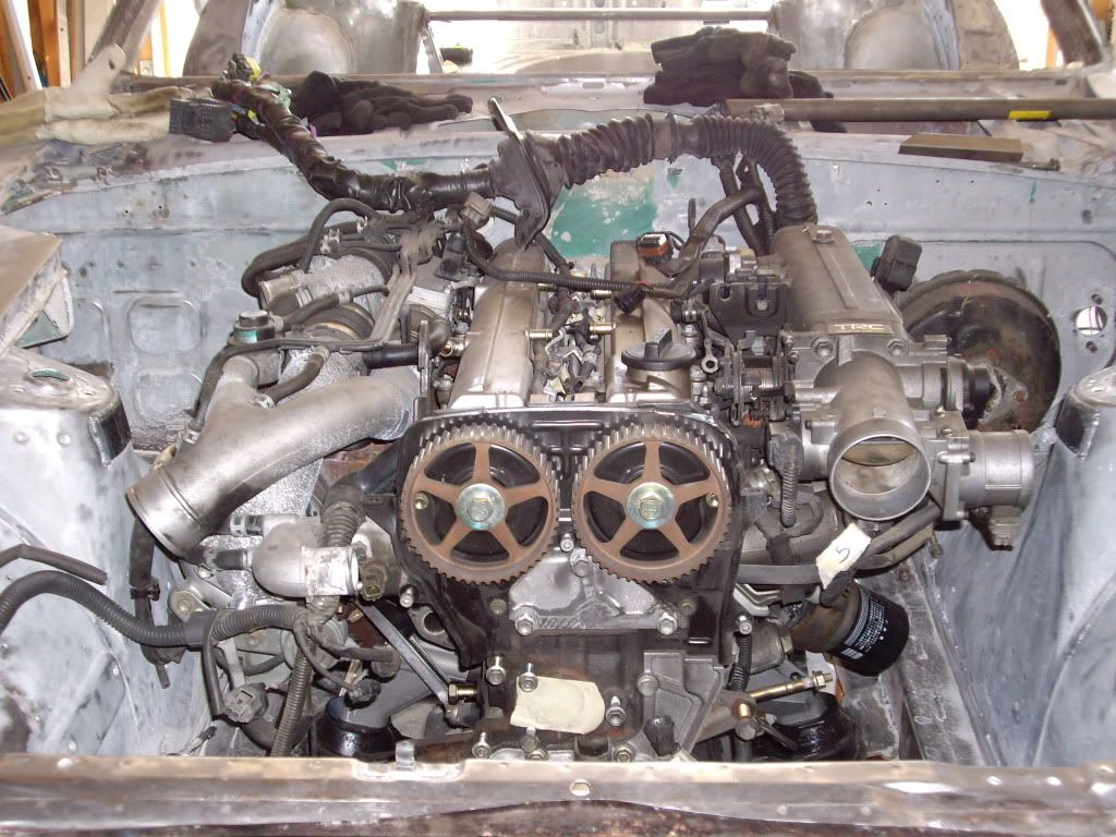

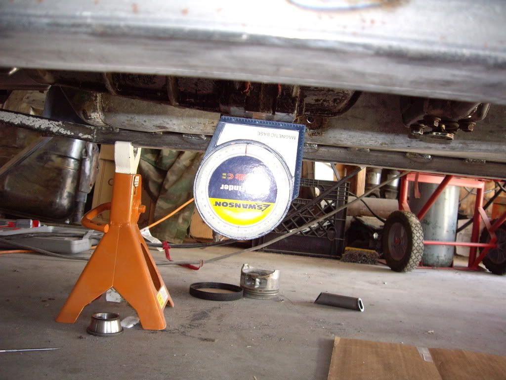

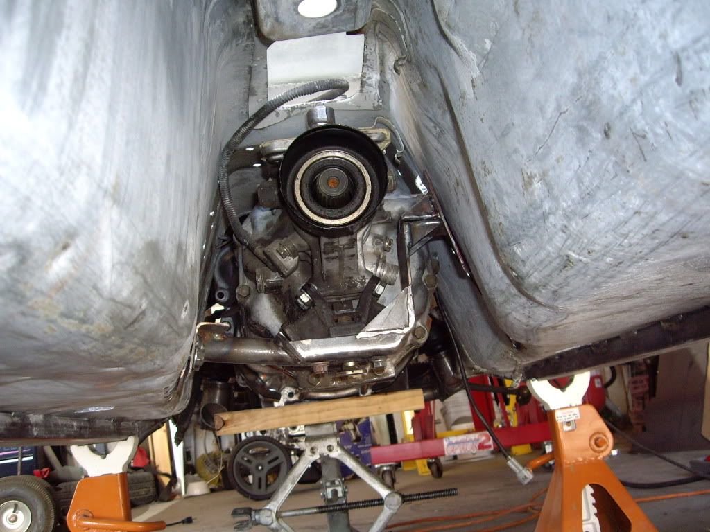

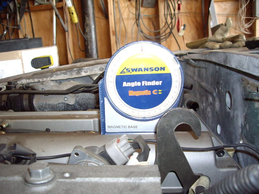

jkgts1 Posted July 12, 2009 Author Share Posted July 12, 2009 Quote Link to comment Share on other sites More sharing options...
