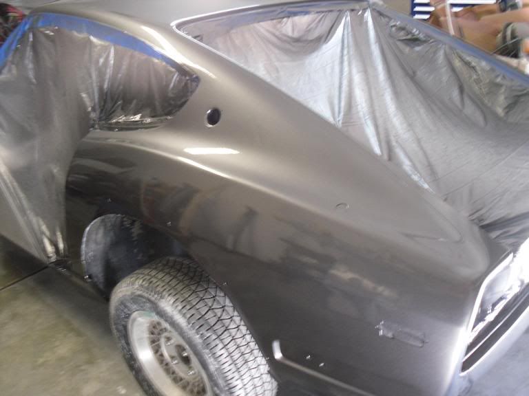

z-ya Posted September 30, 2009 Share Posted September 30, 2009 Looking really sweet! Did you blen just the color, or did you have to blend the clear too? On my rear quarter I blended the color coat and it came out nice. Now I need to blend the clear at the roof pillar. I was going to use some blending reducer in the clear. Any suggestions? Thanks, Pete Quote Link to comment Share on other sites More sharing options...
piston Posted September 30, 2009 Author Share Posted September 30, 2009 your going to want to reclear it also, not just the base color. heres how i did mine. i sanded it down with 1000 grit 1ft pass the respray area and mask it off there. make sure you get a good smooth sand so use a grey fine scuff pad with scuff gel if availible because it will throw fisheyes in your clear if you dont get a good fine scuff. spray the area and feather it out leaving a 1ft scuff area between the mask base. tack rag run through the base and flash time of corse. now with the clear mixed, reclear it 4-6 inches pass the feather basecoat but the trick is to leave about 5-6"inch scuff area remaining between masking tape and new clear. then with an aerosal clear blending spray can availible from any automotive paint store, spray the cutoff line of the clear with the aerosol blending spray. what this does is melts the new clear into the old scuff clear. flash time, then wet sand it with 1500 and up only! and buff it out. it should come out clean. when you spray the blending spray, be careful to not make it run. the blending spray is not neccesary but i makes wetsanding blend area easier to work with instead of sanding blending in. Quote Link to comment Share on other sites More sharing options...
z-ya Posted September 30, 2009 Share Posted September 30, 2009 Yes, I will re-clear the whole panel. I will blend it in the narrow area where the roof meets the rear quarter. Did you clear right up to the end of you scuffed area and then the blending spray over the last new coat of clear just in that area? Or did you leave a small scuffed area (that was previously cleared), and then just spray the blender there after the last clear coat? This is what I am using for a blending spray: http://semproducts.com/images/tech_files/38403%20TDS.pdf This says to spray it over the blended edge, which I interpret as having fresh clear on it. Thanks, Pete Quote Link to comment Share on other sites More sharing options...

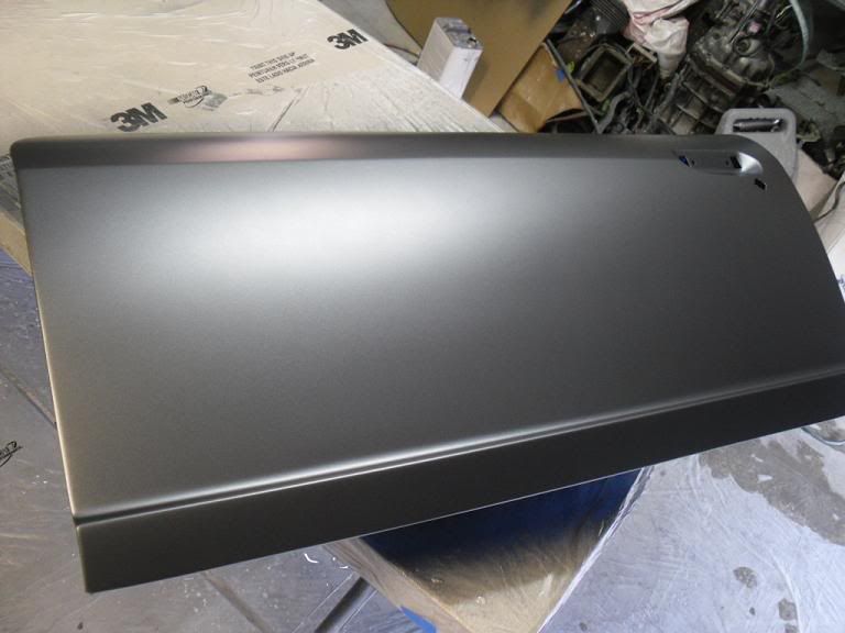

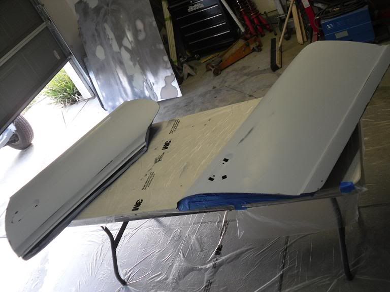

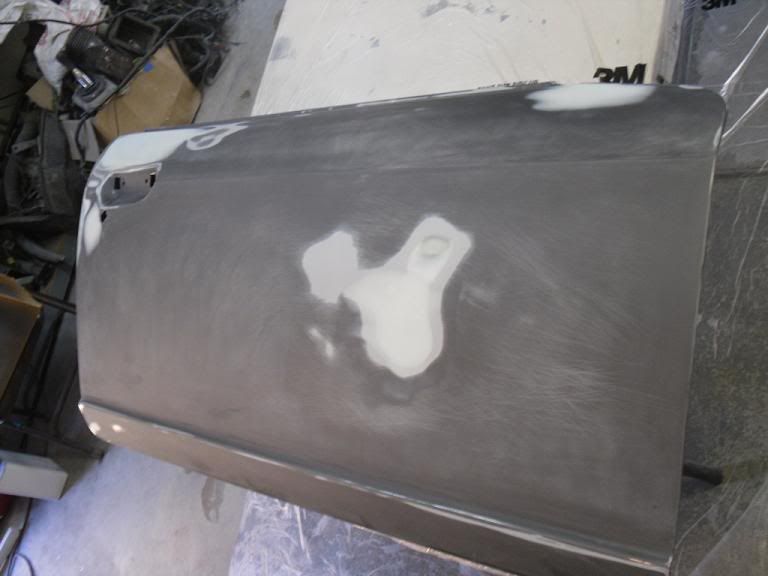

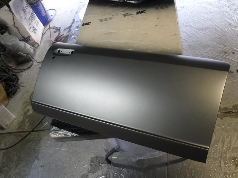

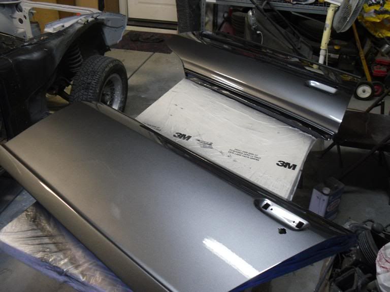

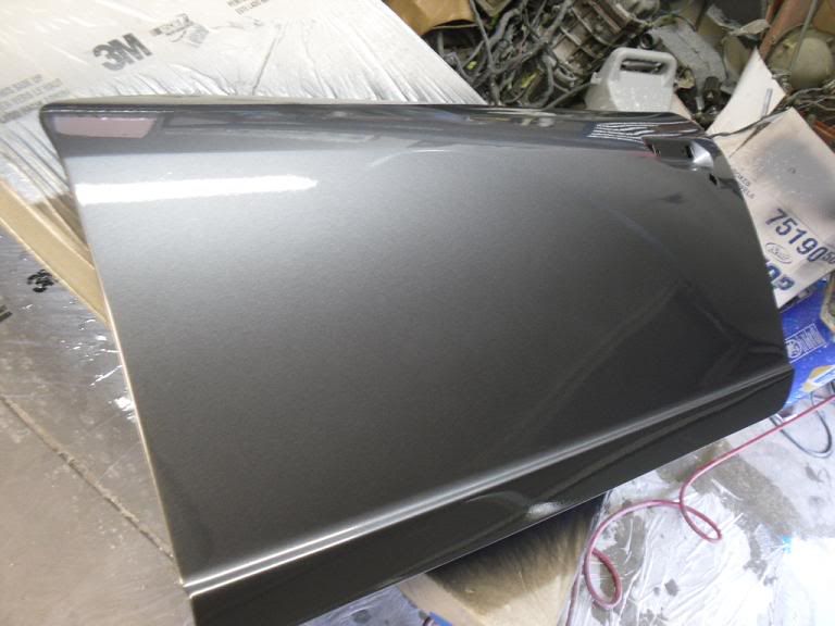

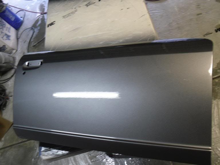

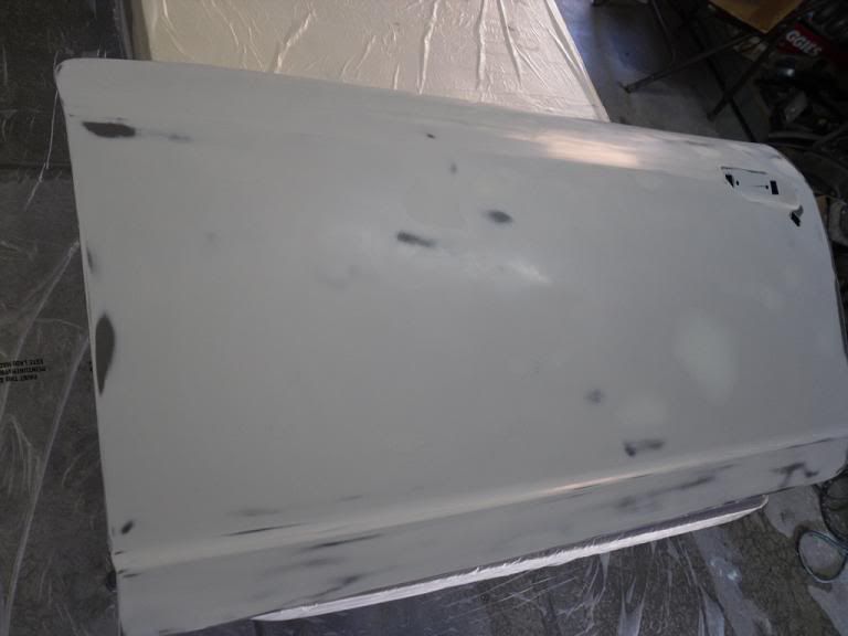

piston Posted October 5, 2009 Author Share Posted October 5, 2009 (edited) this weekend i touched up the doors with bondo on low areas and reprimered them saturday. wetsand this morning and just finish spraying this 10 mins ago. is so freaken hard to spray metalic on flat areas and not have dark spots but i think i managed to pull off this one being patient and walking around the doors looking for dark areas as i lay down mist coats of metalics on to even things out. the doors on the z are so flat its almost impossible to smooth a ding flat. if you have a beat up ding up odoor, have fun..here you can see my low spots i touched up on the white round spots. for some reason i had a high spot. and more lo spots on passenger door. check out the 220 scratches. both sanded down and sitting waiting for paint as i mix. after 3 coats of base metalic and a mist 4th coat. 2-3 coats of wet on wet clear for this clear im using and dont worry about wasting clear, just dump it and throw the extra away. i use to try and use as much as i can and find mself dealing with runs. thats a PITA. they will sit here like this for the rest of the night until tomorrow. i have a bad habit of looking at them after fresh paint and screwing it up or accidently rubbing the fresh pant. so im calling it a night. Edited October 5, 2009 by piston edit Quote Link to comment Share on other sites More sharing options...

z-ya Posted October 5, 2009 Share Posted October 5, 2009 My doors were worse than that. I'm happy with how they look now. Nice work. I know about runs in the clear. I blended my rear quarter over the weekend and it came out great except for the runs in the clear coat. What was the procedure you used to sand out the runs? Are you concerned with panels not matching because you are painting the car piece meal? I guess if you are consistent with the same primer, same color lot code, same number of color and clear coats you shouldn't have a problem. Hopefully I don't as I has to re-paint one door, the hatch, and one front fender. Everything else was done all at the same time. I'll know when I get it all together and out of the garage. Pete Quote Link to comment Share on other sites More sharing options...
piston Posted October 5, 2009 Author Share Posted October 5, 2009 the runs are a pita. im considering redoing the panel because of the clear running. no matter how much you wetsand it, the run wave will be there as it all goes down at the same levelwhen you sand. its not noticeable but like i say, because i know its there, i can see it. plus i pulled it out into the evening sunlight and notice minor metalic flakes glow more in some spots from certain angles, annoys me. im going to redo the body rear panels over since i got extra paint and clear. im just going to reclear the whole side panels. damn...lol. looks good from 10 ft away though!!! Quote Link to comment Share on other sites More sharing options...

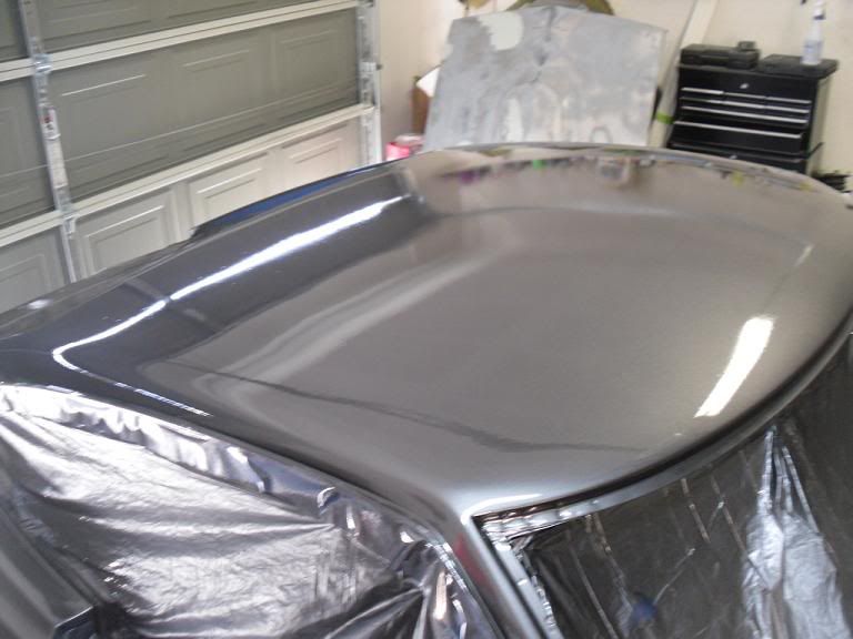

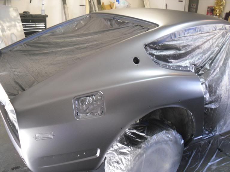

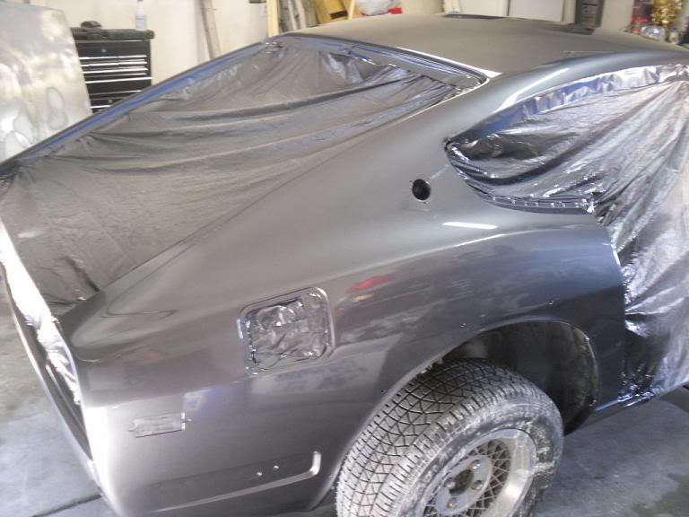

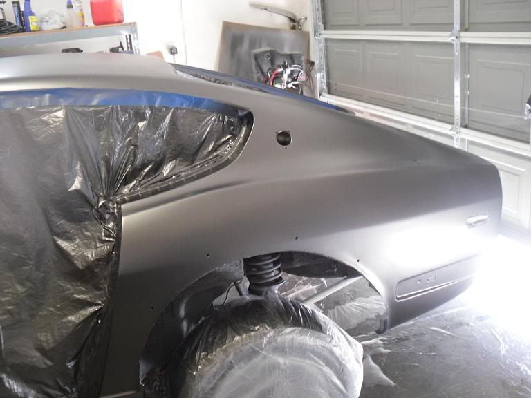

piston Posted October 12, 2009 Author Share Posted October 12, 2009 (edited) repaint the chaisis today after two days of bordy work on the clear coat run and minor defects/low on driver side. it will never be perfect so oh well, came out better than first time. 3 coats of base. 3rd mist coat to even out metalic. 2 coats of clear wet on wet. roof. one tiger stip in the middle but thats ok, thats where my cut off was. but notnoticeable. seems like its the same pic over and over buts its progress for me and a crap load of sanding and prep work. i have a feeling its going to be slightly off color by a bit but we'll see what happens when its all together. i have a new solution to take care of the clear runs. use a DA and 800grit, machine DA the area dry.. fallow 1000grit by hand andbuff it out. Edited October 12, 2009 by piston pics Quote Link to comment Share on other sites More sharing options...

piston Posted October 16, 2009 Author Share Posted October 16, 2009 i know about the razor blades but thats really risky. i tried it and its hard to control the blade and angle of cut and went into my primer. lol. the trick is to tape the ends of the blades to raise the edges and cut perpendicular. i say use a hard metal block and sand with 800 or just DA with 800 and go fine from there. Quote Link to comment Share on other sites More sharing options...
