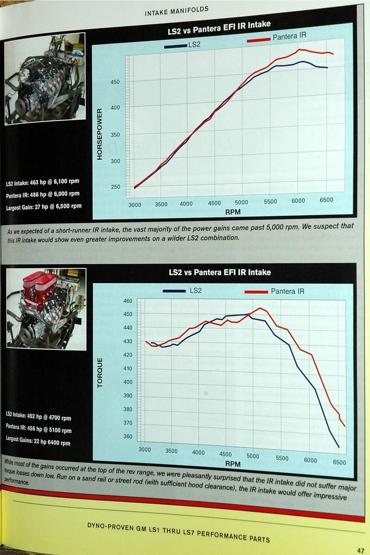

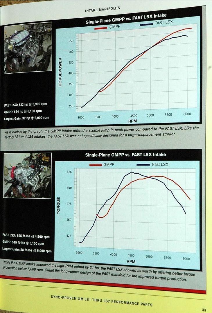

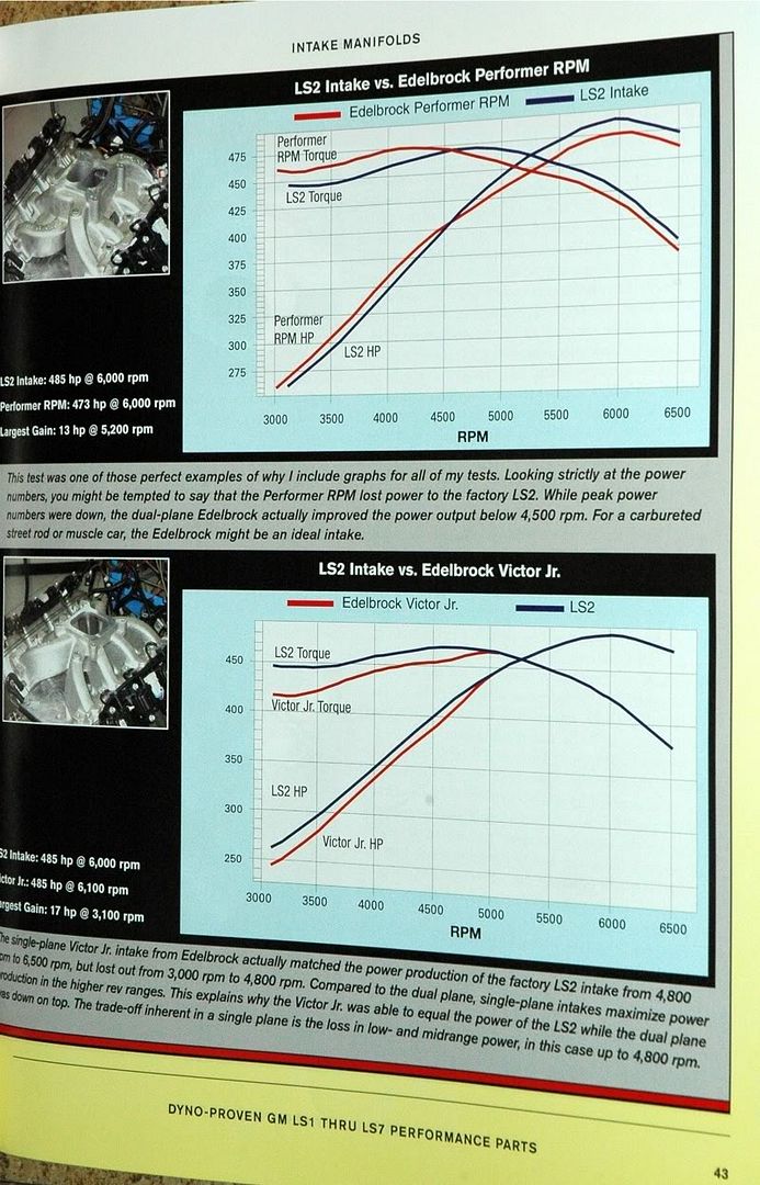

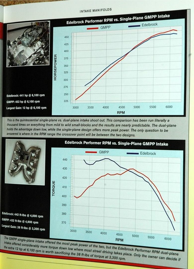

Administrators BRAAP Posted August 14, 2009 Administrators Share Posted August 14, 2009 These Dyno charts came from this book; Courtesy SA design There are even more Carb dyno sheets comparing different cylinder heads, cams, etc. Personally, I don’t put much stock in the actual numbers, just the shape of the power curve and when back to back such these are, the trends of what the changes produce are good “indicatorsâ€! On to the charts… FAST LSX EFI intake vs GMPP single plane and Holley 850 Engine; 408 stroker, (6.0L truck block), no specs on the cam sorry. Courtesy SA design Edelbrock Performer RPM, (dual plane) vs GMPP single plane. Engine; LS1 crate engine. Lunati VooDoo 212/218 @ .050†.531†lift, 113 LSA Hooker Long tube headers. Barry Grant 750 Mighty Demon Carb Courtesy SA design LS2 intake vs Edelbrock Performer RPM, (dual plane) and Edelbrock Victor Jr. (single plane) Engine; LS1 crate engine Lunati VooDoo 212/218 @ .050†.531†lift, 113 LSA Hooker Long tube headers. Barry Grant 750 Mighty Demon Carb Courtesy SA design LS2 intake vs Pantera EFI ITB’s Engine; LS2 crate engine. Crane Z series cam, (216/224 @ .050â€) Hooker long tube headers. Courtesy SA design Quote Link to comment Share on other sites More sharing options...
