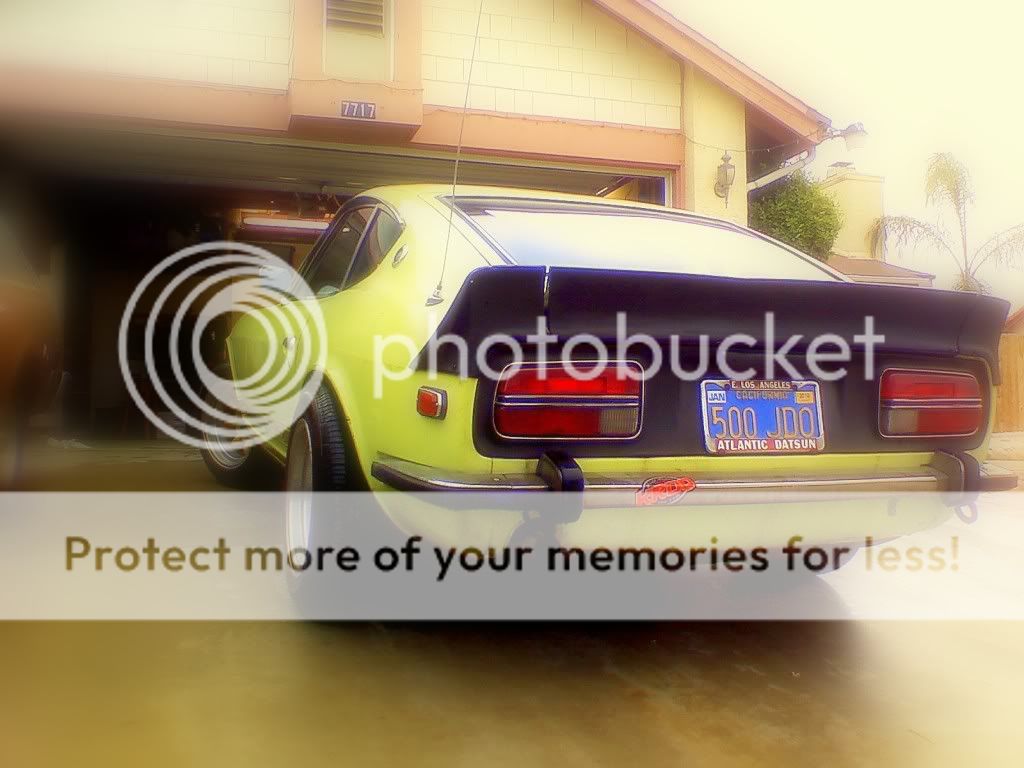

I just obtained my Z a month ago with plans to slowly make her presentable with a little bit of kick. The car currently is running on an L28 carbed with 5 speed transmission, MSA Headers, 2 1/4" exhaust piping with a straight pipe, Carb spacers?, Performance coil, NGK platinum plugs and wires. For suspension, it is sitting on ST springs (I believe I got the infamous mislabeled ones since my front sits higher than the rear), Tokico Blues, End Links and front and rear ST sway bars. For brakes, I am using the Toyota 4x4 calipers. For wheels I have some 15x10 Panasports on cheap 205 60 15's. I am planning on getting coilovers for better stance and handling, ZG flares so no more rubbing and fender mirrors. I am also in the process of transplanting my newly built L28ET. My goal is to be around 400 to 500 HP at the crank but for now, 300 should keep me going while I'm breaking it in. Oh and how could I forget, I will be refreshing the chassis as well with reinforcements and eliminating rust. The car will be painted Gloss black. The transformation will be slow but she will get there. Anyway, comments and suggestions are very well appreciated.

forgot the pics

Looks good! I like the black hood on yellow. Already lookin' mean :)

The hood is actually going away since I'm swapping hoods with my friend since his has a hole for a top mount turbo. I won't be making a vent or a cover because I love the intimidation that it'll bring :mrgreen: But I will have a filter to cover the turbo so no birdies get sucked in.

Since I haven't obtained all the parts that I need before I can drop the engine in, I decided to mount my ZG flares for now. Next project is to switch the ST springs from front to rear. I think the rears are supposed to be the fronts and vice versa.
I still need several parts before I will drop the engine in. Hopefully I can get her running by early December if not earlier. Stay tuned...
