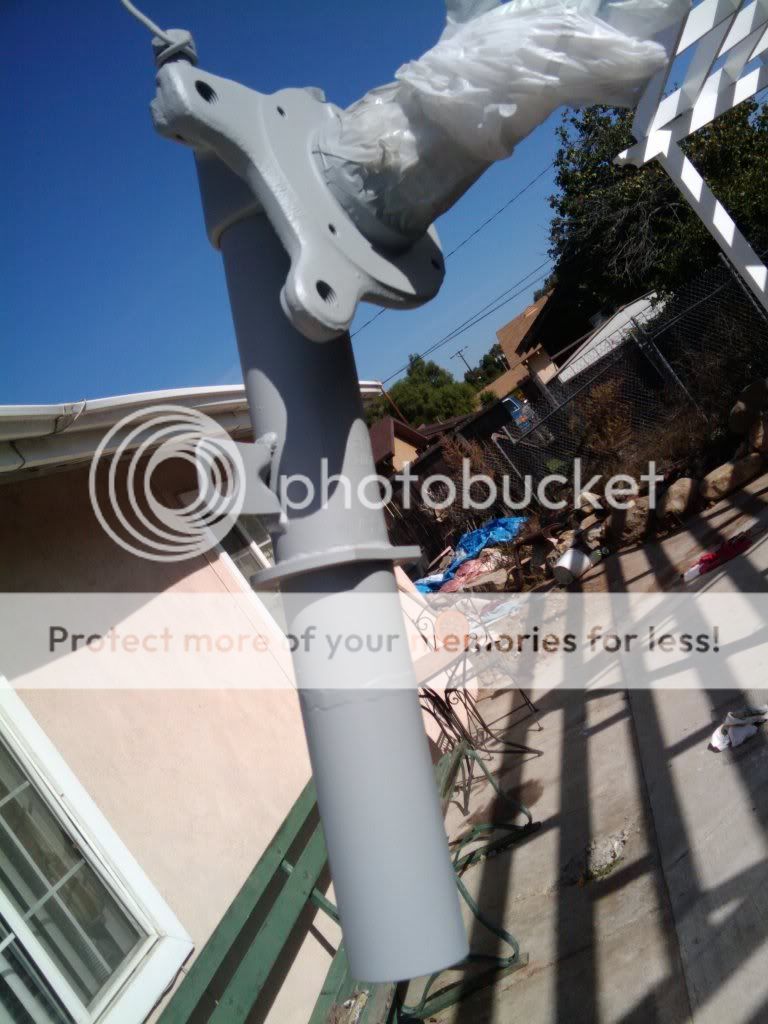

shika805 Posted October 24, 2009 Share Posted October 24, 2009 yup you gotta replace the spring perch with a new one to fit the threaded collar.... here's mine with the ground control collar perch that came with my kit Quote Link to comment Share on other sites More sharing options...
