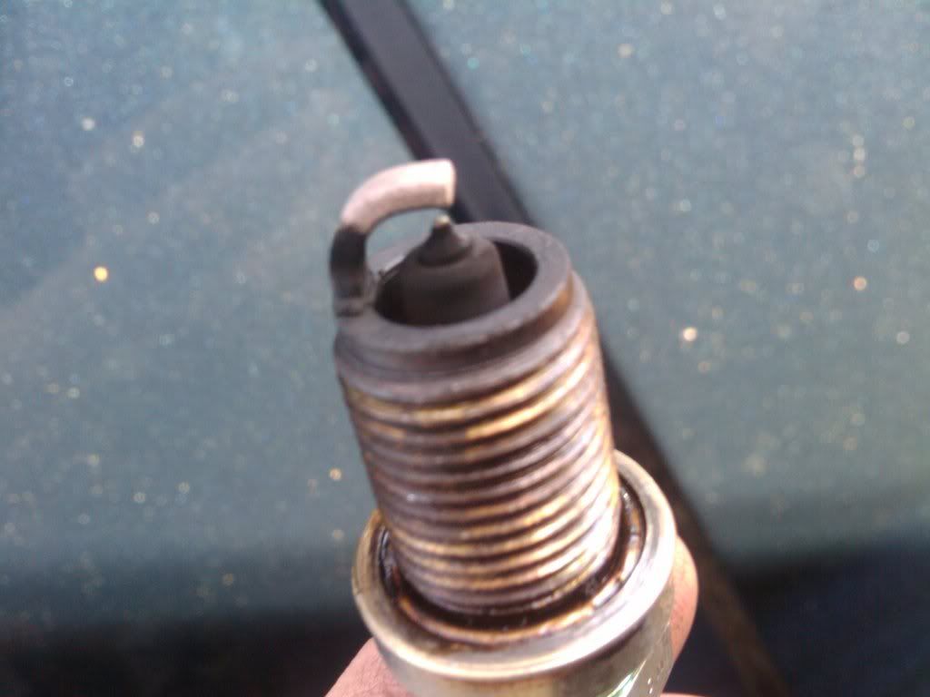

Bernardd Posted December 3, 2009 Share Posted December 3, 2009 what do the sparkplugs look like? and make sure not to plug that o2 sensor back in.. Quote Link to comment Share on other sites More sharing options...
KnightoftheRound Posted December 3, 2009 Author Share Posted December 3, 2009 All the plugs look like this more or less: Video, sorry for the bad audio, the G1 can take nice pics, but a camcorder it is not. Car sounds like my dads turbo diesel Isuzu Trooper.... Quote Link to comment Share on other sites More sharing options...
Bernardd Posted December 3, 2009 Share Posted December 3, 2009 Try new plugs, have you checked the continuity from the plug to the ecu from the maf/cas/chts? When you checked the timing was the engine fully warmed up, tps closed or shorted? Or did leave it alone form the stock efi setting? I see the engine is an 81, did you swap to the 82-83 cas setup? Quote Link to comment Share on other sites More sharing options...
KnightoftheRound Posted December 3, 2009 Author Share Posted December 3, 2009 Those WERE new plugs. Yes, I have checked for continuity in the CHTS harness, CAS harness, MAF harness, TPS harness, and O2 (now disconnected) harness. None of those harness's, save for the MAF harness, were touched from the old setup which ran perfect. I rechecked the MAF harness today from the plug to ECU with an 84 Z31 diagram, there are no faults with it. I went to a local Z yard here, and tried an 86T computer, and an 84T computer, both had the same results. About to go out and RE-RE-RE-check all the damned harnesses again, this is so frustrating. FWIW, the switched 12v source for the MAF, I used one of the b/w VCM wires. For the switched 12v source for the Fuel Pump relay, I believe I used a wire from some connector that looks like -| hanging under the dash near the silver cylinder shaped thing that works the turn signals and such. Quote Link to comment Share on other sites More sharing options...
