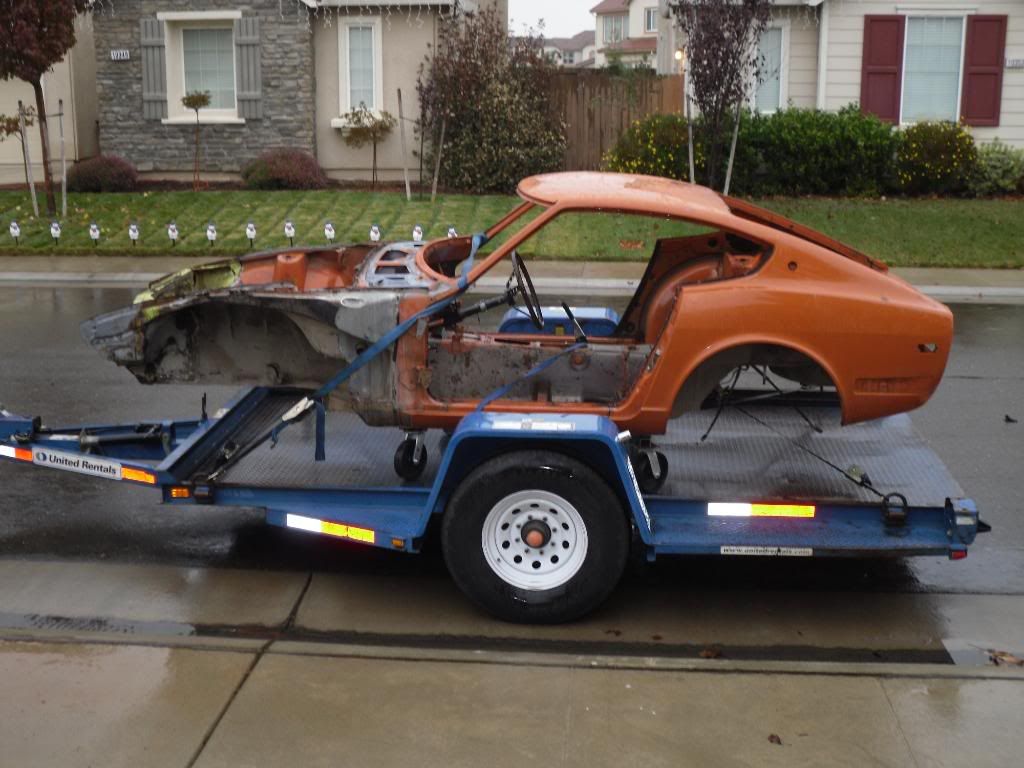

Z-Noob Posted December 24, 2009 Author Share Posted December 24, 2009 I'm picking up the car from the media blaster Monday. The blaster called me Monday to tell me it was the cleanest z he had ever seen. No rust or cancer 100% solid! So the frame rails should be good to go for the bd frame rails. Thanks Quote Link to comment Share on other sites More sharing options...

Z-Noob Posted December 25, 2009 Author Share Posted December 25, 2009 I stripped the vehicle to the bare chasis. Nothing was left. It was $600 for the blasting and $400 for a "baked On" primer. This did not include any fenders, hood etc etc. Just the bare chasis. I ordered a soda/sand blasting setup so I will be blasting the fenders, hood, suspension etc. myself. Quote Link to comment Share on other sites More sharing options...
