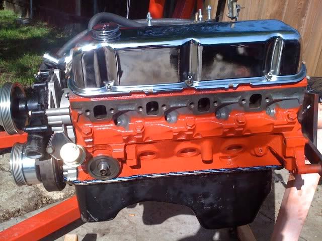

So I built my 302 last week put it back in the 280. I also installed a new fidanza flywheel and I am a little nervous about the dowel pins. I didn't press them in place... i just taped them in with a hammer and now I am thinking back over everything I did and that one brain fart seem to just haunt me. I am worried they are gonna fly out doing 90 on I-15 and tare a hole threw my bell housing or damage something catastrophically. I am an Aircraft mechanic so I am constantly worried and conscience about FOD (foreign object debris) am I over reacting or should I tare everything back out and double check my work? IMG_0313.jpgIMG_0312.jpg

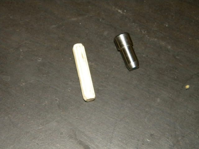

Well this is a dead topic sine i pulled the motor and fixed the problem but just for everybody's knowledge and for future searches. Fidanza's flywheel dowel pins must be pressed in because because there is nothing else to hold them in place. I probably would have been fine just hitting them in but I am nervous like that and it was easy to do with a vice. Ford's flywheel dowel pins are wider were the go into the flywheel and smaller were they match up to the pressure plate... so when the pressure plate gets bolted to the flywheel the clutch will hold the pins in place. so if the dowel pins in far enough to install the clutch they are not going anywhere.
you can see here on the right is a stock Ford dowel pin (the fat end goes into the flywheel)
On the left is a pice of wood that serves as a good analogue for the fidanza dowel pin I don't have available for a picture (it look almost exactly the same just a bit smaller and made from steel)
