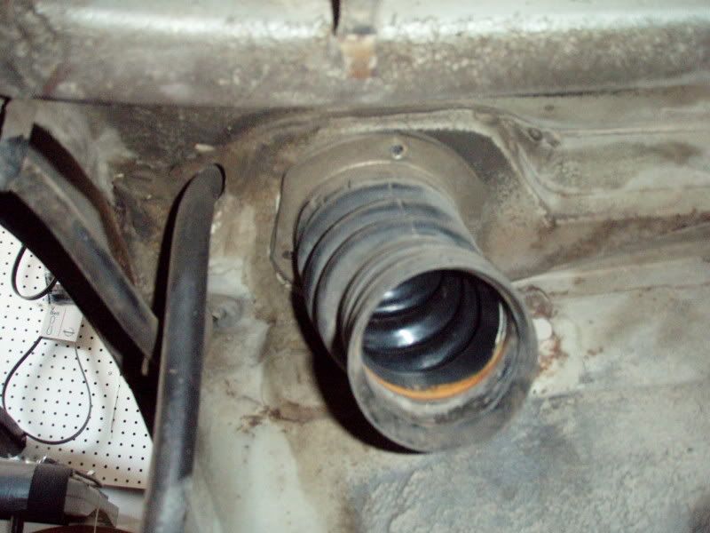

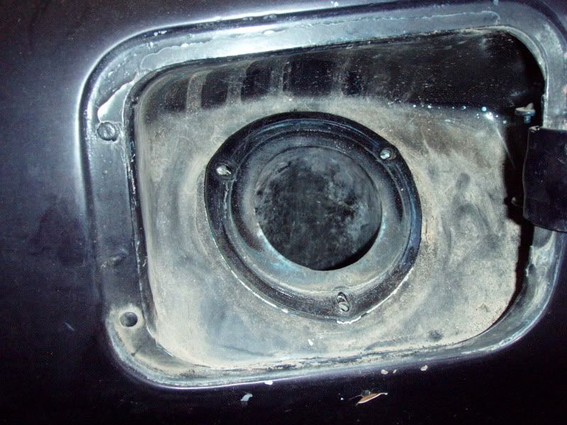

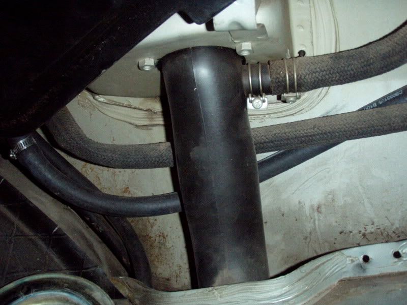

UofA_ZCar Posted February 25, 2010 Share Posted February 25, 2010 I have searched and I have look in the FSM but I can not figure out how to remove this hose. I removed all 6 screws but there seems to be lips that overlap the body both on the top (2nd picture) and bottom (3rd picture). So can someone tell me what I'm missing or tell me which page of the 73 FSM I can find it on? Thanks Quote Link to comment Share on other sites More sharing options...

johnc Posted February 25, 2010 Share Posted February 25, 2010 From the top, bend the rubber lip into the flange opening and then push it down. Then work the whole filler tube out the bottom of the car. Quote Link to comment Share on other sites More sharing options...
sweetride2go Posted February 25, 2010 Share Posted February 25, 2010 It's a PITA, but ya, what John said. ^^^ Quote Link to comment Share on other sites More sharing options...
UofA_ZCar Posted February 25, 2010 Author Share Posted February 25, 2010 From the top, bend the rubber lip into the flange opening and then push it down. Then work the whole filler tube out the bottom of the car. That's what I thought but I didn't want to chance it with 30 year old rubber until I confirmed. Thanks for the replies. Quote Link to comment Share on other sites More sharing options...
johnc Posted February 25, 2010 Share Posted February 25, 2010 Oh, you're still chancing it, but that's the method for removing the filler tube. Quote Link to comment Share on other sites More sharing options...
Philly_G35 Posted February 26, 2010 Share Posted February 26, 2010 I used a heat gun to warm mine up before I pulled it through. I don't know if it helped, but it came out in one piece. Quote Link to comment Share on other sites More sharing options...
langfordchuck Posted March 3, 2010 Share Posted March 3, 2010 yes, the heat trick is important, or at least very helpful.... I used a heat gun to warm mine up before I pulled it through. I don't know if it helped, but it came out in one piece. Quote Link to comment Share on other sites More sharing options...
