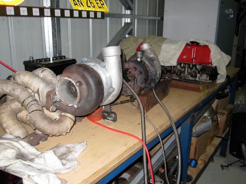

jacob80 Posted March 9, 2010 Author Share Posted March 9, 2010 Absolutely not! Everybody knows red as a background color for exhaust housings just makes their flanges look bigger than usual! Har har har! I only ask because I have never ever once heard of or even seen a flange welded to the exhaust turbine housing prior to this photograph. Quote Link to comment Share on other sites More sharing options...
RB26powered74zcar Posted March 9, 2010 Share Posted March 9, 2010 Har har har! I only ask because I have never ever once heard of or even seen a flange welded to the exhaust turbine housing prior to this photograph. They must not work to bad if they are producing and selling turbine housings with the flange on it. Quote Link to comment Share on other sites More sharing options...
Nigel Posted March 10, 2010 Share Posted March 10, 2010 They must not work to bad if they are producing and selling turbine housings with the flange on it. Where did you find that? I saw a similar piece in the book Maximum Boost, that looked like the picture jacob80 posted, but it was actually cast, and not welded. I think this is a brilliant idea, but I could never find a vendor. Having an external wastegate flange cast into the turbine housing would really simplify installation and I think flow very well, possibly even better than what one could come up with for a custom header. A lot of the custom manifolds I've seen have the external wastegate plumbing doing 180 deg turns from the direction of flow because of a lack of space. My only concern is will it clear the intake on an L28? Nigel '73 240ZT Quote Link to comment Share on other sites More sharing options...
Nigel Posted March 10, 2010 Share Posted March 10, 2010 OK, I found it. As I suspected, ATP Turbo sells it: http://www.atpturbo.com/mm5/merchant.mvc?Screen=PROD&Store_Code=tp&Product_Code=ATP-HSG-043&Category_Code=GTH Unfortunately, it only comes in a T25 housing That sucks! Maybe if enough people ask, ATP will make a T3 version. Or, does anybody know of another vendor who makes a T3 version? Nigel '73 240ZT Quote Link to comment Share on other sites More sharing options...
Xnke Posted March 17, 2010 Share Posted March 17, 2010 Looks like you can check the box for a t3-t4 turbine, with a t3 flange, so i would say it's a strong possibility. Quote Link to comment Share on other sites More sharing options...
