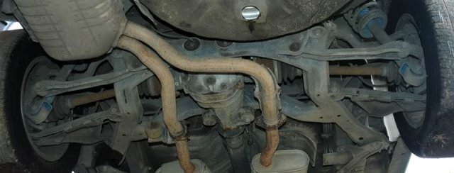

acidrain088 Posted March 3, 2010 Share Posted March 3, 2010 I have been on this board for a little over a year so i thought it was tome to start my own build thread. Last spring i purchased the shell of Clive's (evil c) old Evil Z. Its a 73 240z. The car will receive a lq4-t56 combo that will eventually have a turbo and the body is getting an imsa wide body. Last summer i repaired all of the rust on the front, Fully seam welded the front clip, installed new sub frame connectors and undercoated the front clip. Also every suspension component i am reusing was taken down to bare metal and painted. since the fall i haven't had too much time to work on it due to my last year of college but ive started work again. Last weekend I got the front end rolling freeing up some jack stands and started getting the rear quarters ready for the massive tires and 300zx rear subframe. Here is a collection of the progress so far. \ Quote Link to comment Share on other sites More sharing options...
acidrain088 Posted March 3, 2010 Author Share Posted March 3, 2010 ^my front wheels ^ comparason of stock, rears and fronts ^the rear tires compared to the stock rears ^ what will keep the tire within the body V Quote Link to comment Share on other sites More sharing options...

acidrain088 Posted June 10, 2010 Author Share Posted June 10, 2010 What wheels, Tires, offsets are you going run? Mongo The wheels are stock cobra r wheels with 10.5x17 rears and 9x17 fronts with 24mm offset. The rear subframe is now fitted and after a meeting with the local z club i should be able to align this properly and get this thing really rolling. I havent decided how the front is gonna be but I want to a flare or sort of widebody. Im gonna wait untill i can see the car together and running to decide. Quote Link to comment Share on other sites More sharing options...

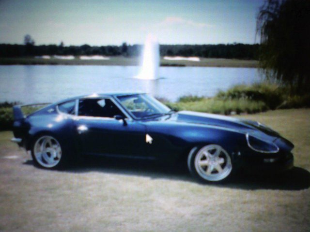

77turboz Posted June 12, 2010 Share Posted June 12, 2010 Wow. Thats exactly what I plan to do with my car........ I will be going with the q45 rear but other than that. Definitely subscribing to this. Maybe we can keep each other motivated. The second pic is what Id like my car to look like. Quote Link to comment Share on other sites More sharing options...

pbagchi Posted January 13, 2011 Share Posted January 13, 2011 just to update everyone on this car, I bought it in September of 2010. I'm planning on finishing her up over the next few years. I was originally going to swap my '75 280Z over to a LS1/T56, but then decided to start with some fresh metal. This car had a lot of things I was planning on doing, already done so it made sense. I still have my '75 so I can keep driving that when this one gets me frustrated. This way I don't rush the build. I'll get started on her in a few months when I finish college, and (hopefully) get a job back around home. For now, I'm planning on doing a '02 LS1 or LS6/T56 with the R230 and hopefully I can get the 300zx TT rear subframe to work. I'll be using the IMSA rear flares, and I'll probably get some flares for the front as well. Once I get started on her, I'll make sure to start up a build thread. I've got most of my inspiration to get into these cars from this forum. I've always been a muscle car guy at heart, but I fell in love with the Z as soon as I drove one. So this is the best of both worlds! Quote Link to comment Share on other sites More sharing options...
