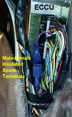

Nissanxrma Posted March 11, 2010 Share Posted March 11, 2010 (edited) I've been thinking about getting NISTUNE, however I'm wondering if I can remove the top speed limiter without something like that? Non-Turbo's don't have a speed limiter. Turbo's do. You cut the Purple wire (Pin #29) going to the ECU. Edited March 11, 2010 by Nissanxrma Quote Link to comment Share on other sites More sharing options...

Axel Kain Posted May 22, 2010 Share Posted May 22, 2010 but wait there's more... http://www.zeeyalater.net/mods.htm#revlimiter Quote Link to comment Share on other sites More sharing options...
jc052685 Posted May 22, 2010 Share Posted May 22, 2010 Yes nistune can change the rev limiter & speed limiter. Quote Link to comment Share on other sites More sharing options...
Nissanxrma Posted May 26, 2010 Share Posted May 26, 2010 but wait there's more... http://www.zeeyalater.net/mods.htm#revlimiter Yes Nistune/JWT and other ECU's can change the rev limiter, but cutting the purple wire only disables the speed limiter. Quote Link to comment Share on other sites More sharing options...
