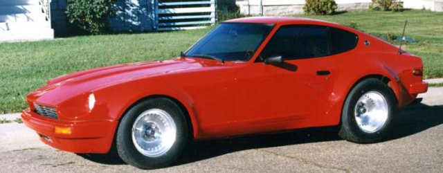

Dudeboy Posted March 14, 2010 Share Posted March 14, 2010 (edited) If you are looking for steel flares, the best transition to the Z body are the Porsche 930 Turbo flares. There is a Gunmetal Gray Z with Porsche flares floating around the web. I have a picture in album of the yellow Z with turbo flares. I post a picture of a red Z my brother e-mailed to me. I think the guy who built the yellow Z got the instructions from the guy who built the gray Z on how you cut the flares down the middle, remove middle sections to get the arch to fit the wheels you are going with. I have a set of Porsche fiberglass flares you do the same way, but fill in with fiberglass, instead of welding like the steel flares. The closest I have seen is some people have used VW bugs. The old 60's -70's and shaved them down. http://forums.hybridz.org/index.php?/topic/62876-what-flares-does-mark-rolston-have/page__p__583156__hl__bug%20flares__fromsearch__1entry583156 I see you are in St. George ever make it to Vegas? Since you are so close I might be interested in paying you to do some custom stuff for my Z. Edited March 14, 2010 by Dudeboy Quote Link to comment Share on other sites More sharing options...
