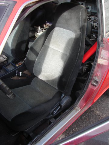

I love my eclipse seats all I did was drill out the spot welds for the Stock rails and I bolted Stock Z rails on and they work just fine, I can go measure how much Height they have left. I'm about 6 Foot and I like to lean the seat back a notch or two and I have a few inches of headroom. The thing I like about them is that they look stock but they are more comfortable and cloth. I got mine from a 1992 Eclipse GS, I'll go take some pictures and measurements.
EDIT: with the seat in the furthest upright position there is 6 inches between the top part of the seat and the roof. I will get some pictures of how I attached the seat later, my camera is acting up.
