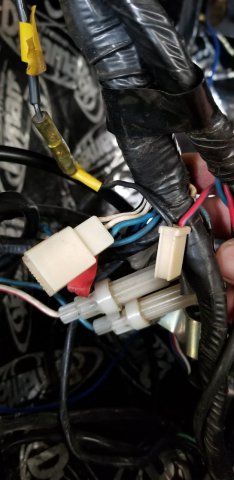

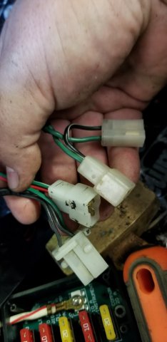

Hey all, I have found many threads and many inconclusive advice or comments about wiring under the dash. I have a very important Z Club event to attend in a little over a week and I need to get this sorted. I have 90% of this stuff figured out between searching for posts and reading the wiring diagram. On my 1973 240z, I have these few remaining wires that I cant figure out where they go. They don't appear to match up with any of the items on my wiring diagram, or any of the relays in my bundle. I could very well be missing some parts down here too. Here goes: 1. The two here that I am questioning is the three prong (WB - W - L) and the two prong (B - RL). These are coming down from the passenger side 2. This one is two wires coming together in a female spade connector? Seems odd... (R - B). 3. This next one has the double headed two prong connectors (TOP). Both are (G - BW) coming from the right passenger side harness. I have read that this has something to do with the electric fuel pump that this car was equipped with and has since been replaced with a Carter electric pump. Then there's the two prong (R - GW) that comes from the center harness. and the three prong (K - K - G) that comes from the center harness. I will continue sleuthing through the FSM and whatever posts diagrams I can find, just thought I would toss this up in case someone already knows everything and wants to win some hard earned forum cred. Thanks! - Alex

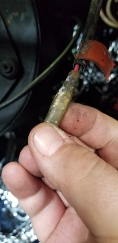

Success! Ok so try and follow me here. Here is my theory of the melted fuse box: (Please correct me if my logic is flawed.) The Flasher fuse melted above due to a faulty fuse. The fuse was supposed to fail and break the circuit, but instead of blowing out the connection it sort of tried to turn into a light bulb. Meaning the fuse element did not blow out it just sort of melted causing a high resistance heat source. Replaced the fuse above and all of my dash gauges started working again as expected. Back to the high beam issue: After a few days of studying the wiring diagram and talking to everyone and their uncles about WTF. Noone has ever seen this issue before but everyone agrees that there is a short/ground issue in the high beam circuit. My wife (of all people) was looking at the wiring diagram and said: "If you think you hooked all of this up right, then you are looking for something that is not on this diagram".. .lol EUREKA! I installed some LEDs to replace the indicator lights in the stock gauges (Directional signals, brake, and HIGH BEAM indicator lights). Turns out the High Beam indicator LED is in line with the actual high beam circuit and I installed it like an ass of jacks. Red lead to the RED/WHITE high beam circuit and black lead to the dash ground that I created for my gauges effectively grounding out the high beam circuit at all times. I also read that the high beam selector switch just changes which circuit is grounded (!) and not which circuit is getting power. That means that all I was doing my flicking the high beam switch is changing the path of least resistance hence changing which headlight's high beam element is illuminated (booyah). Thoughts? Shit is working. My passenger high beam isn't as bright as the driver so I'm not completely out of the weeds, but the indicator and high beams are operating properly enough. I want to thank everyone that chimed in here. Even the little assumptions and facts that were brought up assisted in my overall understanding of the system, thus making it more and more obvious what and where I screwed up. Thanks!
Thanks SJ. I will update the blog soon. Just been focusing on getting this damn car up and running so I can enjoy it again. Turned into the project that wouldn't end so I had to start banging things out. So here's a fun development! First Z club meet of the year and the car is running great. Halfway home my dash lights go out on my four center gauges. Take a look at the fuse box when I get back and this is what I see: Even without the fuse the two leads test 4ohms between one another. Woops! Gonna track the source of this down. Hopefully there isn't permanent damage to the harness beyond what I can see here.
