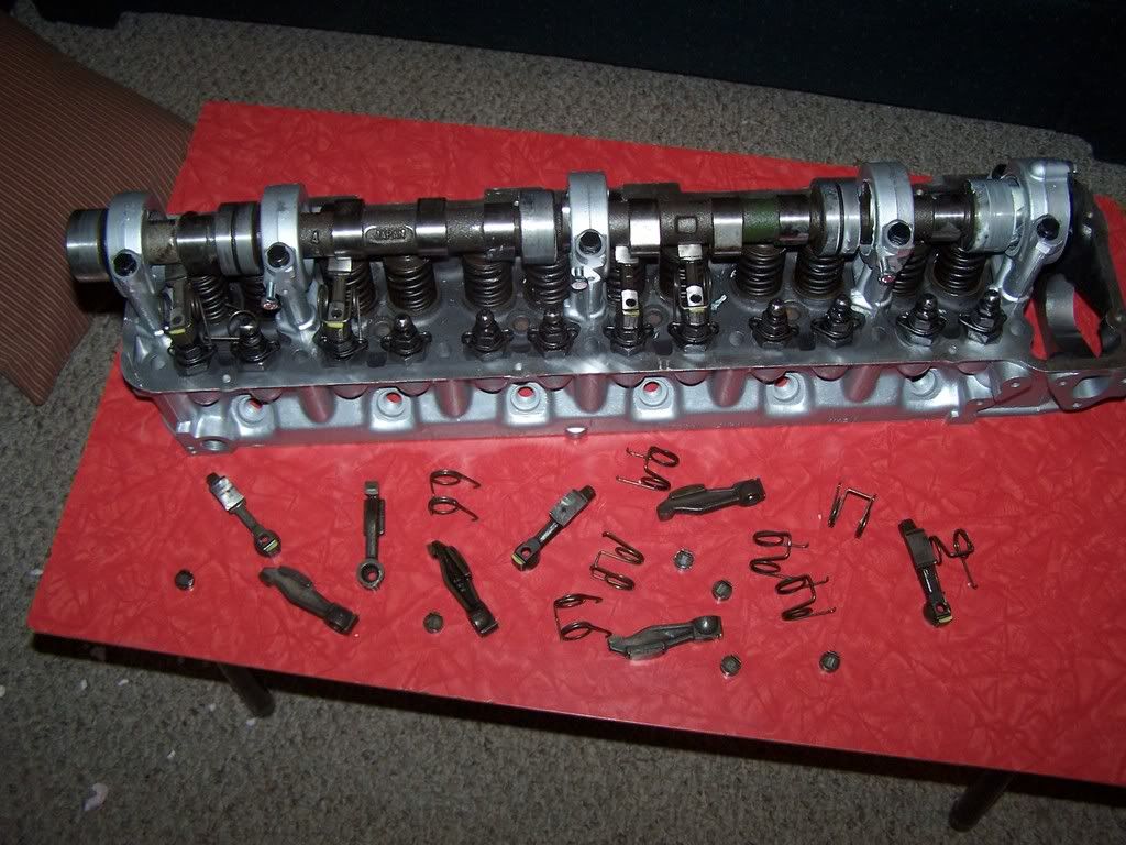

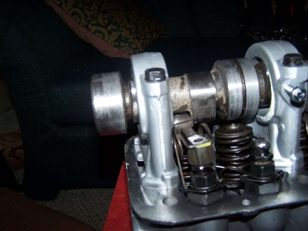

Whoa! You had to grind the lock nuts to adjust the valves? You have other, possibly very serious problems with that head. Post a pic of your valve train so we can take a look at it, or get it to a mechanic you trust to look at.
Mongo
and ya the guy who i got the "rebuild head off of ebay may have not done the best job, the valve lash was to tight on a few of the exhaust valves so the only way to change it was to take of the nut and grind it down so the lash could be adjusted for more clearance. so the valve guides my be bad.
Mongo
okay, i have a few pictures but none that really show much i would have to take the head off if you wanted any pictures of the valves, i can get some of the cam and rockers later but heres what i ahve now.
those nuts...

Ok, I know nothing, so take anything I have to say as a best guess and nothing more. It looks like the surface of the head or the base of the cam towers was shaved. I have shims under my cam tower, don't know if that is stock or not, came to me that way. I don't know how to properly set the wipe pattern on these heads, but I know you can get different thicknesses of lash pads too. Something doesn't look right, thats for sure.
