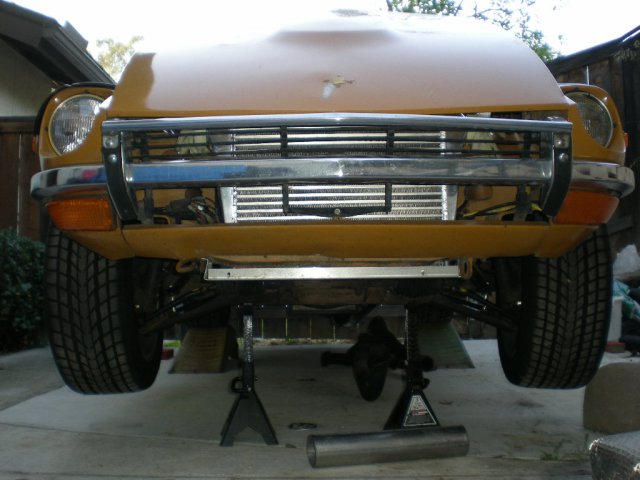

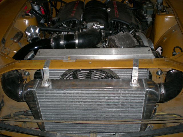

ColtGT4g63 Posted April 22, 2010 Share Posted April 22, 2010 Hope you don't plan on running more then 6psi of boost with those 60 lb injectors. at 8psi I was at 98% duty cycle with my 60lb siemens deka injectors on a 5.3L. This was at 43 psi base fuel pressure. I've also got a twin Walbro 255 set up with a -10 feed line. I've recently upgraded to 80lbs The intercooler I am using on my Datsun is a 20" x 12" x 3". Fits perfectly between the openings on the side of the core support. Its always hot / warm on one side and very cold on the other. Data logs don't show IAT's rising excessively either. I paid 130$ for it off of Ebay. Pics: Quote Link to comment Share on other sites More sharing options...

ColtGT4g63 Posted April 23, 2010 Share Posted April 23, 2010 The dimensions described were of the core only. Quote Link to comment Share on other sites More sharing options...

280Z76LS2 Posted April 24, 2010 Author Share Posted April 24, 2010 The dimensions described were of the core only. what about the inlet and outlet size any idea? thanks Quote Link to comment Share on other sites More sharing options...
ColtGT4g63 Posted April 24, 2010 Share Posted April 24, 2010 3" inlet / outlet. This is the same intercooler I've got, except this one has 2.5" inlets / outlets. Quote Link to comment Share on other sites More sharing options...
