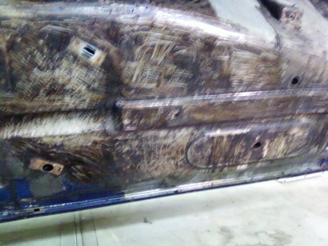

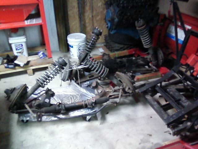

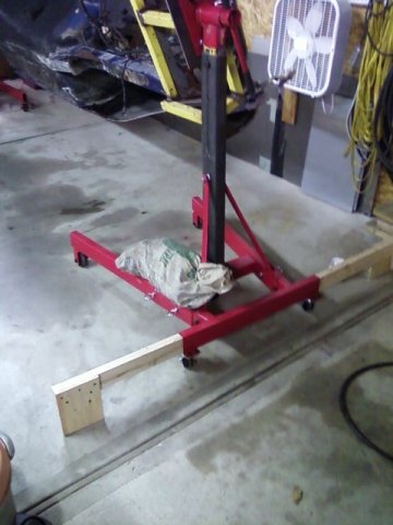

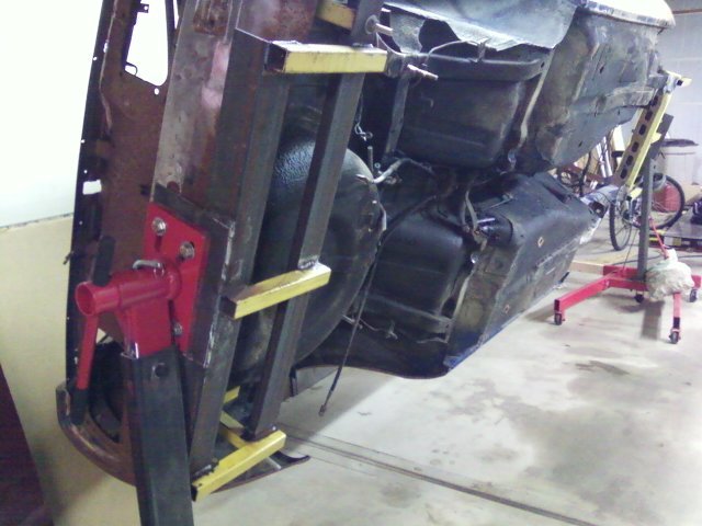

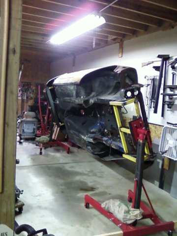

Zinpieces Posted May 9, 2010 Share Posted May 9, 2010 Well today was day one. My 1971 Z was purchased as a roller a few months back. After spending a lot of time learning from this site and preparing my game plan I finally got down to work. Today I pulled the front and rear suspension and put the car on my homemade rotisserie. Next step will be to finish removing all the lines, hangers, cables etc. Then I am considering having the body dipped. I cleaned a small section with a scraper and a wire wheel on a die grinder, that will take forever so I am looking for a good stripper. Anyone had any experience dipping their cars? I am in New Jersey. As the project moves along I'll post again. This forum is the best resource I have, thanks! Quote Link to comment Share on other sites More sharing options...

Zinpieces Posted May 13, 2010 Author Share Posted May 13, 2010 I did some checking and got general agreement that dipping my Z is not a great idea, Thanks. So I'm going to do the underside old school. A propane torch with a flame spreader and a putty knife will remove most of the undercoat and paint, then I'll wipe it down with solvent. sounds like a lot of work , and it is, but its also practically free! the small section I did took about ten minutes. Quote Link to comment Share on other sites More sharing options...

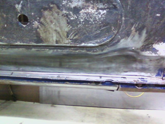

Zinpieces Posted May 24, 2010 Author Share Posted May 24, 2010 Well today was day three, I only count the days I get to work on the car! I spent a few hours removing the undercoating the old school way. I removed a section at a time with a propane torch and a scraper. Then I set up a baby pool under the car and applied lacquer thinner using a garden sprayer. I used a parts brush to clean and the thinner washed away the residue. I recovered the thinner, ran it through a filter and will reuse it as long as it remains effective. I call myself Zinpieces, I'll include a picture of the car as I bought it, That will explain everything. Last week I ordered a SBC kit from JTR, hoping to get that this week. Quote Link to comment Share on other sites More sharing options...

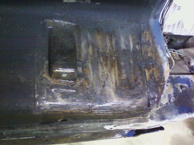

Zinpieces Posted June 13, 2010 Author Share Posted June 13, 2010 now that the bottom is pretty much cleaned up I removed the sound deadening material and the HVAC equipment from inside the car. I used a six dollar Harbor Freight impact chisel to remove the sound deadening mats. The chisel worked great ,lowered the air pressure a little guided the chisel by hand and did both sides in under 1 hour. Then I put the car back on the lift and straightened the floors and subframe where the old owner drove over something. Next its back on the rotisserie to weld in the Bad Dog rails. Quote Link to comment Share on other sites More sharing options...

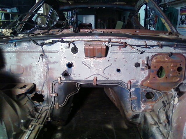

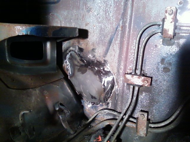

Zinpieces Posted June 13, 2010 Author Share Posted June 13, 2010 Today was weld up some holes in the firewall day. I will be using an Old Air Products Hurricane heat and AC system and their piping goes through the bulkhead in a single opening. Quote Link to comment Share on other sites More sharing options...

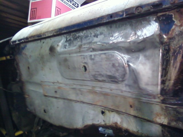

Zinpieces Posted June 20, 2011 Author Share Posted June 20, 2011 Time for an update, the frame rails are in and the bottom is mostly cleaned up. I did the cleaning of the bottom old school with a propane torch and a scraper. So far I have used only one 14 oz. bottle. I decided to cut the back of the frame rails and install the end piece first. That gave me the best fit. Then I added the center section. By overlapping the two rear pieces and doing a little metal forming with a torch I got a smooth finish. I also boxed the front with some metal of the same gauge. Next up is fitting the rear suspension and installing the gas tank. I got a universal tank with in tank pump from Tanks Inc. I also got some really cool goodies from Gabriel at T3 to complete my R-200 install. Tomorrow I hope to cut out the spare tire well Quote Link to comment Share on other sites More sharing options...
