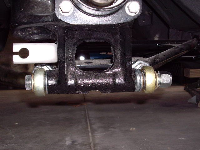

jkgts1 Posted May 9, 2010 Share Posted May 9, 2010 (edited) Hi, for those that are more knowledgable than me, probably most of you, I am installing adjustable rear control arms from T3 (Gabe). I noticed that there is quite a bit of space at the spindle pin pivot point. The arms cam with a set of washers, but even with all the washers used I still have alot of forward and aft movement. Should I just make some spacers to take up the space? It is kind of hard to see in the pic but there is at least a 1/4 inch that is not being filled by the washers. Here is a picture. Edited May 9, 2010 by jkgts1 Quote Link to comment Share on other sites More sharing options...
evildky Posted May 10, 2010 Share Posted May 10, 2010 Hi, for those that are more knowledgable than me, probably most of you, I am installing adjustable rear control arms from T3 (Gabe). I noticed that there is quite a bit of space at the spindle pin pivot point. The arms cam with a set of washers, but even with all the washers used I still have alot of forward and aft movement. Should I just make some spacers to take up the space? It is kind of hard to see in the pic but there is at least a 1/4 inch that is not being filled by the washers. Here is a picture. yes you should shim it, you don't want the upright movign at all! Quote Link to comment Share on other sites More sharing options...
JMortensen Posted May 10, 2010 Share Posted May 10, 2010 Not only should you shim it, but you should shim it so that the strut lines up correctly with the strut tower up on top. The further from perpendicular you get, the more side load you put in the strut as the suspension compresses. Quote Link to comment Share on other sites More sharing options...

jkgts1 Posted May 10, 2010 Author Share Posted May 10, 2010 (edited) Not only should you shim it, but you should shim it so that the strut lines up correctly with the strut tower up on top. The further from perpendicular you get, the more side load you put in the strut as the suspension compresses. This was my next question. What is the best way to make sure it is perpendicular? Edited May 10, 2010 by jkgts1 Quote Link to comment Share on other sites More sharing options...
JMortensen Posted May 10, 2010 Share Posted May 10, 2010 (edited) What I did was to assemble the suspension without the spring, and set the strut so that it lined up dead centered in my camber plates. If you don't have camber plates, I'd try to line the 3 studs of the top hat with the strut tower, or bolt the strut top in and aim the strut shaft towards the hole in the top hat. Then I said "Screw this!" and made a new control arm where the strut doesn't need to stay perpendicular: http://forums.hybrid...n/page__st__120 I think idea behind the arms in that thread are far superior to anything for sale commercially. Edited May 10, 2010 by JMortensen Quote Link to comment Share on other sites More sharing options...

jkgts1 Posted May 18, 2010 Author Share Posted May 18, 2010 Please don't laugh at me . . . but what exactly do you mean by shim? Are you saying that you should center the strut such that the space is equal on both sides to allow for the most perpendicular setup possible? (once again, flaming if you must haha) The RCAs come with a bunch of washers, but found out from Gabe that the washers go on the inside none on the outside. Once I did that all the space was taken up. But it doesn't mean you have to use the same amount of washers on each side. Every car is a little different with minor tweaks here and there. So, the idea is to get the control arm to move its full range of motion without binding. Well, I'm guessing that is the idea. Quote Link to comment Share on other sites More sharing options...
silverarrow27 Posted May 18, 2010 Share Posted May 18, 2010 The RCAs come with a bunch of washers, but found out from Gabe that the washers go on the inside none on the outside. Once I did that all the space was taken up. But it doesn't mean you have to use the same amount of washers on each side. Every car is a little different with minor tweaks here and there. So, the idea is to get the control arm to move its full range of motion without binding. Well, I'm guessing that is the idea. Curious, how many big and small ones did you use on your car? As mentioned above, I'm using the same amount on both sides, 4 big washers and three small washers on each side for me. Quote Link to comment Share on other sites More sharing options...
