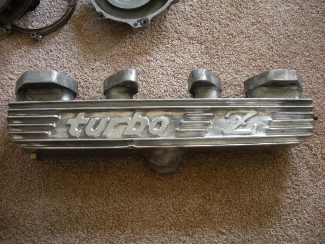

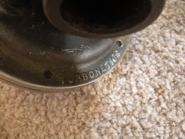

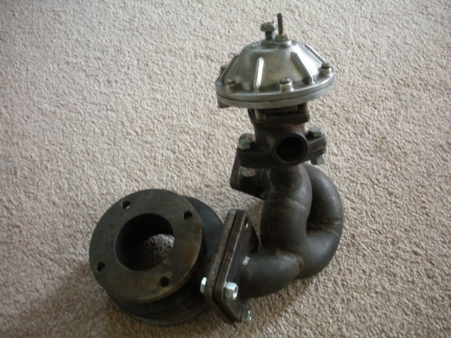

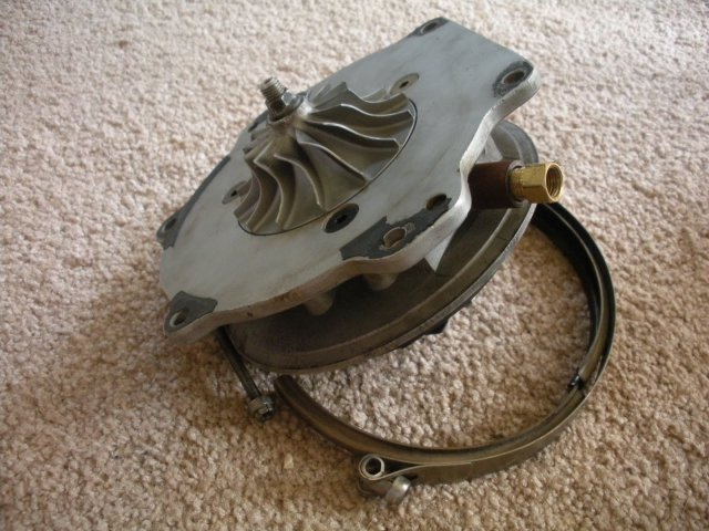

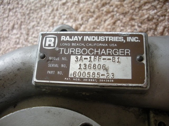

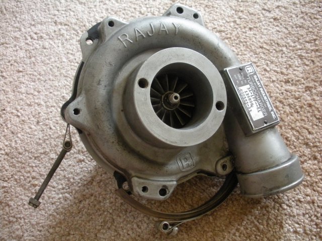

ksbeta Posted May 24, 2010 Share Posted May 24, 2010 Good Morning, I bought my first Z over the weekend, a Green 1970 240z. It's a running project car, really in pretty good shape, but the guy just had other priorities. He gave me all kinds of neat facts, something about no bracing existing in the doors or hood to lighten it up ("deathtrap" being the word he used), but it runs great and is a blast to drive. He had a turbocharger kit that he threw in with the car. It's made by RAJAY INDUSTRIES, INC and, well, I'll spare you the little I know, because it's probably wrong. If anyone would be gracious enough to have a look at these photos and tell me what they see, I'd appreciate it. Thanks much. Bill http://picasaweb.google.com/WDesrosiers/1970Datsun240z?feat=directlink Quote Link to comment Share on other sites More sharing options...
yetterben Posted May 26, 2010 Share Posted May 26, 2010 (edited) I see a plate of Linguini a women who looks like oh great...and a old draw through rayjay setup. Pretty much trashcan fodder. keep the intake and the wastegate ditch the turbo. Your valve cover is worth a little bit of coin as well. Edited May 26, 2010 by yetterben Quote Link to comment Share on other sites More sharing options...
ksbeta Posted May 27, 2010 Author Share Posted May 27, 2010 Hey thanks for taking a look, yetterben. I'm pretty new into the Z world and don't know squat about these older parts. The Linguini was delicious. The lady was not impressed. Ok so the Rajay stuff is junk, huh? Bummer. It wasn't my goal to turbo the car, but if I had some decent stuff on hand, it may have been something to consider down the line. What's the story on the valve cover? Quote Link to comment Share on other sites More sharing options...
johnc Posted May 27, 2010 Share Posted May 27, 2010 Hey thanks for taking a look, yetterben. I'm pretty new into the Z world and don't know squat about these older parts. The Linguini was delicious. The lady was not impressed. Ok so the Rajay stuff is junk, huh? Bummer. It wasn't my goal to turbo the car, but if I had some decent stuff on hand, it may have been something to consider down the line. What's the story on the valve cover? I don't know if I'd call the setup "junk." Its probably not worth spending the money rebuilding the turbo and sourcing the parts needed to complete the setup, but its not junk. Clean everything up and put it on eBay if you're not going to use it. Might get some money for it. Quote Link to comment Share on other sites More sharing options...
frank280zx Posted May 28, 2010 Share Posted May 28, 2010 I don't know if I'd call the setup "junk." Its probably not worth spending the money rebuilding the turbo and sourcing the parts needed to complete the setup, but its not junk. Clean everything up and put it on eBay if you're not going to use it. Might get some money for it. RAY JAY is not junk by far. the make turbos for aircraft, but the prize for rebuilt with nowadays turbo prizing might be steep... SO weher does the carb go here ? or the injectors for that matter? Looks neat! and time period.. i love it ! Quote Link to comment Share on other sites More sharing options...

yetterben Posted June 4, 2010 Share Posted June 4, 2010 Draw through frank. Carb mounts on inlet of turbo. Draws fuel, mixes in turbine. Has a special carbon seal in chra if i remember that is nla. Quote Link to comment Share on other sites More sharing options...
Tony D Posted June 4, 2010 Share Posted June 4, 2010 Similar to the Crown/Turbo Toms, etc. Standard Exhaust Manifold with an adapter. Tho that one looks to be non-standard and a weld-el rework--the original stuff was a mandrel bent thick wall tube that corroded out evenutally... A period piece as Frank Mentioned, with any number of Holley TB's or even a GM TBI and standalone you could take care of the cold drivability issues inherent in that design and make a decent daily driver which would look 'period modified' as the modern electronics could all easily be hidden under the big air cleaner. I've seen 10 second Z's (and an 11 second ZX) that run that system, they can make power. just depends on how much you want, and what tradeoffs you are willing to live with in a daily driver... Quote Link to comment Share on other sites More sharing options...
ksbeta Posted June 25, 2010 Author Share Posted June 25, 2010 Sorry, I'm dumb and slow. The thing that says "Turbo Z" on it; that's a Valve cover?? That doesn't seem right to me, but like i said, I'm kind of dumb. Is that what that part is actually called? Someone said it was worth "a bit of coin" - why? Why is that impressive? Thanks again. Quote Link to comment Share on other sites More sharing options...
Xnke Posted June 25, 2010 Share Posted June 25, 2010 That is actually the intake, he just mistook it for a valve cover. the whole setup as a group could bring good money to the right buyer. Quote Link to comment Share on other sites More sharing options...
ksbeta Posted June 25, 2010 Author Share Posted June 25, 2010 Who made the intake? The exhaust manifold? Why is this stuff any good? Quote Link to comment Share on other sites More sharing options...
