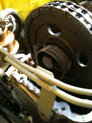

Put the transmission in neutral, take the valve cover off the engine, remove the spark plugs, and (using a big adjustable wrench or the correct size 1/2" drive socket) try turning the camshaft clockwise using the bolt on the front of the cam gear. It should take no more then about 50 ft. lbs. to get the engine to turn.
Update,
Thanks for the replies guys. I tried turning that bolt clockwise as stated and was able to just barely budge it. As it I was just tightening the bolt. I also tried turning the crank pulley bolt clockwise with the exact same result. All this was with the spark plugs removed and the valve cover off. The oil plug is there it appears as if the oil all came out from the valve cover. I was suprised to find that there was no seal or gasket when I removed it. Is there supposed to be a gasket there? Anyway from my limited knowledge of cars and my extensive searching and reading as many motor seize posts as I could find Id say its locked up. Thanks again for the replies Ill gladly try any more suggestions you guys have. Ive read a bit about this murphys magic oil or something but I dont think that would apply to me cause The motors not locked up from rust or corrosion. What do you guys think?

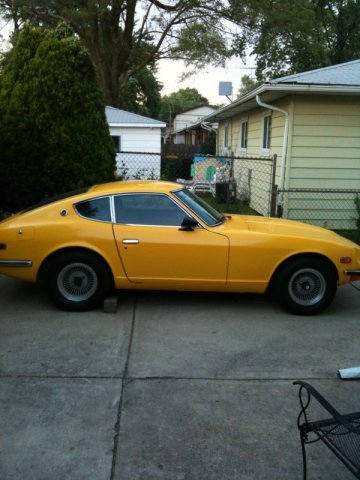

Motor was locked up and I have already started to dissasemble things. I have all the components out of the engine bay except the engine cause Im waiting for my friend to put his motor into his mustang and free up the engine hoist. I also removed the entire dash and center console from the car to further investigate what appeared to be some pretty wacky wiring. It was very messy and will be completely redone. I will post up some pics tommorow of the progress.

Hey Sucks about the engine. No oil will do that. the squeaking you heard was likely the bearings scaring the hell out of your crank. YEah there's supposed to be a thin gasket on the valve cover. look at it this way though, you'll have an upgrade opportunity. Meaning you can now put in the 5speed, and L28 engine for more power than the L24 your 71 came with. You can spend a lot of $ on early Z's too, so watch yourself. Get in mind where you want to be eventually, then everything you buy for the car, Ask yourself, is this going to get me to my goal? Yes, then go ahead, No, then look at it again and ask if you really need it.
